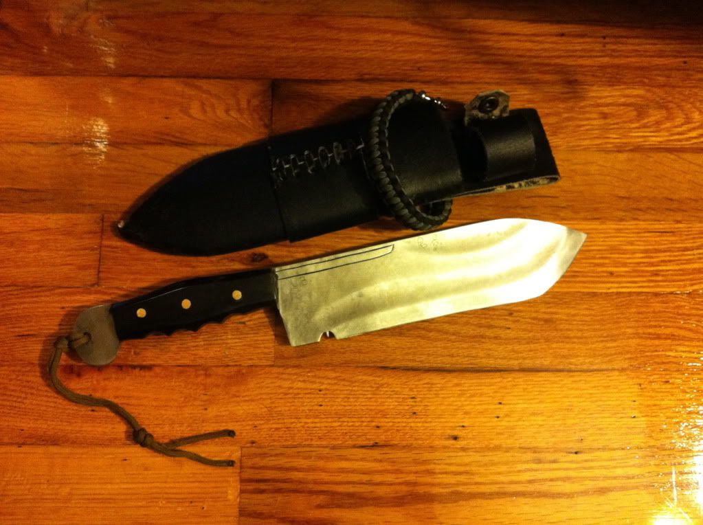

Hey guys, Ive posted about my MCC before, I actually found a pic from a previous owner on bladeforums and the blade is a LOT shinier. When I received it from a trade it has almost a forced patina look to it. I dont want to damage or scratch up the blade but is there a way to get her back to her original luster??
Only way is to buff it out. Time consuming, but it can be done by hand. Buffing compound and elbow grease.
The other way is a buffing wheel and rouge. Quicker, but a heckuva lot more dangerous if you've never used one and don't know what you're doing. A wheel will yank it out of your hand and throw it at you faster than you can say... Ohhh....!!!!!
I think I'll go with the buffing compound. Do you recommend just using the buffing compound with a rag?
Yep, but be advised that you probably wont be able to match the finish of machine buffing.
The other way would be to use sandpaper in progressively finer grades until you get a polished finish. I'd start with 340 grit and work up from there.
Haha, thanks guys. Im off work today so I have a little time to work on it. I can still faintly see some lines from the sandpaper though...
Good......NOW get back out there chopping something and mess it up again !!!!! :thumbup: ;)
