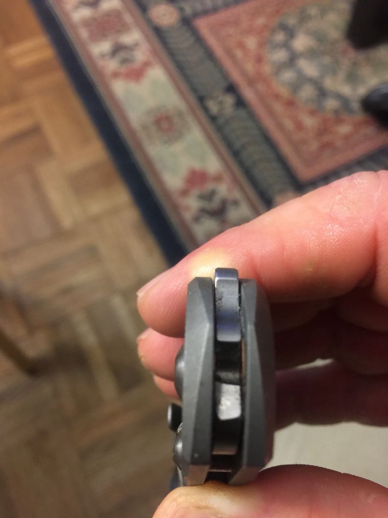

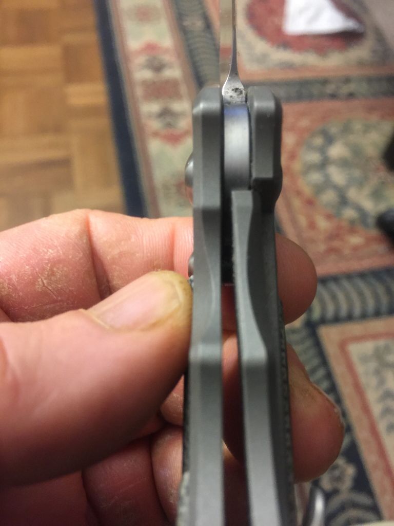

I just bought a used 2013 Sebenza 25 off of the exchange and the knife is in pretty good shape overall but the lockup seems like it is at least 90%. Is this too late even considering the point of contact is the ceramic ball itself?
Pics would help..But yes, remember that the ceramic ball is almost centered with the lockbar.
[/URL][/IMG]
Yep..your good.
Bisect the lockbar..about half- that is where the ball should be..Right around 60%
That is about where my Inkosi is..All good..it's not going anywhere :)
Great to hear. Thanks for the responses bhyde and maylebox. Is this normal amongst these models or is it still a bit late?
It's normal...and really, if you account for the ceramic ball, it's not late either.
Good point, bhyde. I guess I am not used to seeing a lock bar that close to the other slab.
I bet if you look on the blade where it locks up with the ceramic ball, it will show the true travel point. The 25,Umnumzaan and Inkosi have the ceramic ball. I look at the blade to see the lock up position, not the lock bar.
