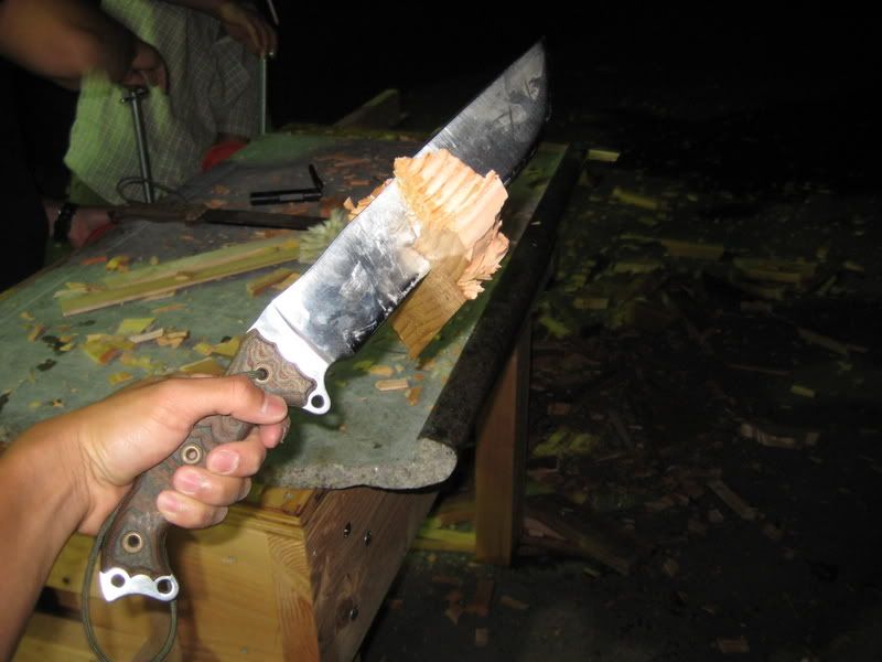

SR-77, in my experience, has superior edge holding to most "normal" carbon steels like 1095, and isn't quite as good at keeping an edge as many higher end steels like INFI. I don't have anything in A2 so can't compare with that. SR-77 definitely doesn't "dull quickly", but it's not going to hold an edge like a fancy super-steel or a good stainless.
It is, however, CRAZY tough - that toughness, along with pretty dang good edge retention, make the steel excellent for chopper-sized blades. To me personally, anything below about 6" is better off with another steel, because toughness isn't as important. The Scrapper 6 is right on that borderline for me, although some folks' preferences are different.
It's hard to tell in this photo, but here's a Scrap Yard Son of Dogfather in SR-77 with a reprofiled convex edge. After chopping and batoning through several hard, seasoned birch logs, the edge was still able to shave arm hair (hairs are barely visible right below the knife, laying on the split log).
