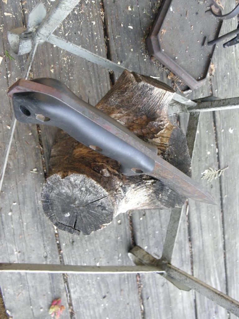

Maintenance up to user here is the 2 standing on her perch for 4 years winter summer fall, not used on food so rust not a problem 5 and 15 due most food,
Just make it yours and deal with what comes,
And a little intimidated by the BK20

Thanks for that picture.. It is helpful in seeing the amount that I would possibly be dealing with

On east coast 1 mile from great south Bay so Figure Beckers only good for 47 years and 9 months left in the elements,
The 2 likes the perch and will remain outside I beat the rust off any and every chance I can
Thats pretty impressive.. Youre saying that youve kept it outdoors for that long?

Man, if you're going to leave the BK2 outside, let me trade you something to take it's place and let me spoil it like a Grandkid.
