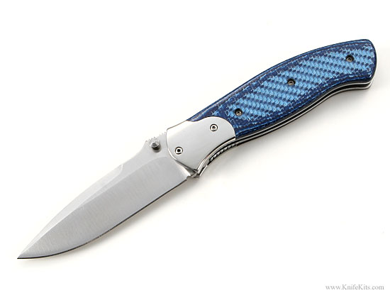

The DDR series, the GX6, and GPC models from Knifekits.com are all excellent quality kits. The DDR3-TC is their tactical version.
http://www.knifekits.com/vcom/index.php?cPath=1

The $46.95 includes all the parts to build the knife except the scales. You can buy the handle material on the same site or check out ebay for stabilized wood. I've found some great looking stuff on ebay at a reasonable price. (Not the best pics but here is some of the handle material I've found on ebay)
