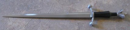

Thanks for that, Mark. What you're saying makes sense, I guess I never though of it from the inside out, as it were. I ordered 2 new horn rolls today. I also got the blade off the grinder and got all the crosswise scratches rubbed out, so I guess it's safe to show a picture now:o
I know there is talent on here that could whip this out without breaking a sweat but this one tested most of my skills and a few of my nerves in the making. The fittings are forged and filed to shape from mild steel, blade is 5160, forged to a tapered blank and the bevels ground in. 17-1/2" overall, 12-1/2" blade, flat ground with a shallow fuller in the ricasso.

The original is in the Wallace Collection, the only photograph I have found of it is on p. 150 of "Arms and Armor of the Mediaval Knight" by David Edge and John Miles Paddock. A catalog of arms in the collection lists it as
"127. Dagger. The pommel is of fleur-de-lys shape; small drooping quillons
ending in spirally fluted knobs. Dec.: none. Horn grip of hexagonal section
narrowing to fit the base of the pommel. The blade, 12-1/2 ins. long, of
diamond section, back edged and grooved 2-7/8 ins. from the hilt.
Probably German, about 1530 (1109)"
There do not appear to be any images of it online.
