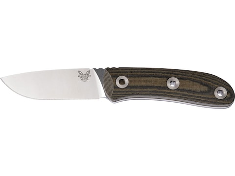

Is this better? Most of the bushcraft knives I've seen had a lanyard hole, so I figured I'd add one to mine. I kind of come and go on whether I use them or not, it's definitely not a deal-breaker for me. If you think it's better to leave it off my first knife, that's not a problem. I highly doubt this will be the only knife I make. ;)
I wasn't entirely sure what you meant by rounding the finger groove into the choil as a small bump. Were you talking about something kind of like this?
That is better. The knife image posted also is a good ( better) basic shape. I would sketch that basic shape on your 9X1.5" area and see if it doesn't look better to you. Then adjust the front of the handle and butt to your liking. This would help you get your blade a bit more aligned size wise, too. As you have it now it is a tad wider than it needs to be.
I would also recommend a full flat grind to start with, as in the image. The 3/4 high bevel you drew looks good in a sketch, but will be very hard to do with no experience.

I tried to keep the blades a little bit narrower than the original design's. Some are, so aren't. I think I'm subconsciously trying to fill in as much of the sketch area as I can. Out of the 4 knives I sketched, #1 is my favorite with #4 being close behind. #1 is based mainly on a Loveless design. #3 is based on the Benchmade in my last post.
