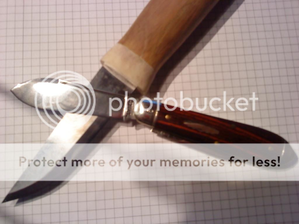

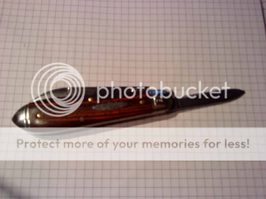

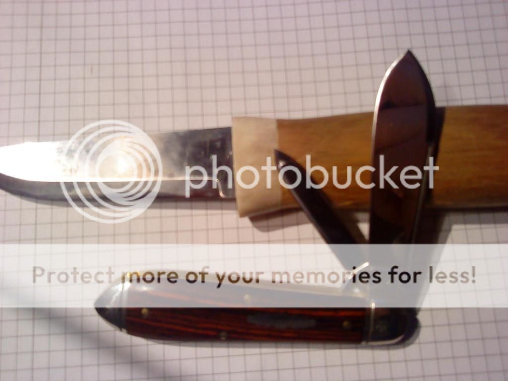

It's my first traditional knife.
Thank you guys for the explanation.
As a reward, here are some pictures, taken with a really bad camera.
I have noticed a few problems with the knife now.
There's a small mark on the edge, and it seems like the blade will hit something in the bottom of the handle if it's pressed all the way down. It'll take some force so I think I can avoid it after resharpening it.
The second problem I can see is that the tip might become exposed from the handle after some resharpening. How do you deal with this?
It also has some very sharp corners at the end of the blades, the part that meet the spring when opened. Do you think it's safe to take the sharpest edge away with sandpaper?

Sharpenening the edge down a bit will, in fact solve your first problem. In the meantime try not to let the blade snap closed. Gently ease it down while grasping it to avoid this problem until you can get it sharpened down a bit. I remember reading a lot of comments from folks who had the same problem with the #85's.
If the tip does become exposed you can file down the "Kick" just a little bit. This is the part of the tang that hits the backspring when closed. In other words, the opposite side of the tang where your sharp corners are exposed. This might be a bit tricky in your case because you will once again lower the blade slightly which might bring you back to problem number one again.
I have sanded down the sharp, exposed corners of the tangs on several GEC knives with no ill effects.
Same thing happens on my #85 Ebony. If I follow the blade closed instead of letting it snap closed then its not really an issue. You can also put a "stop" like part of a match stick or folded up paper right on that spot that the blade hits on the back spring to lesson the impact if you do forget to follow through. This is the only thing I don't like about the knife.
I like the Cocobolo on that one btw. I have on just like it :thumbup:
