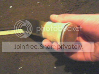

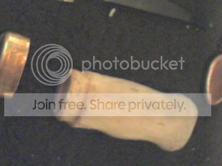

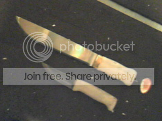

Lots of information here guys, thanks :) and ive got my profile a bit more updated though im not quite sure where everything is for this site yet.. Ive gotten all the materials i need for this knife and have already made the tang hole and shaped the handle.. no before pictures but ive taken a few of how it all will look.. once properly cleaned up and attached!

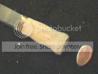

Here is the knife mostly assembled(loosely) with a knife i used to carved most of the wood off before filing.

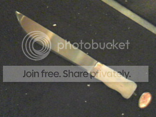

Just the knife
Close up of the butt of handle with tang protruding where cap will go
Close up of blade and ferrule

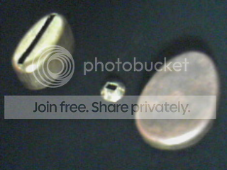

Knife parts

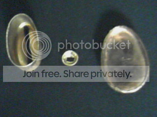

Close up of parts
What i plan to do is fill it with epoxy and under the ferrule and butt cap for a solid handle. What my next question was, is wether or not it is a good idea or at all necesarry to peen the tang either down to the handle and epoxy the buttcap onto it, OR to drill a hole into the butt cap and peen onto that (which i dont really want to do.) and the other alternative is with the JB weld wpoxy i plan to fill the handle with if peening would even be needed or just a kind of "nice touch" or extra measure. How it is now no epoxy or peening the handle is very snug on the tang and i have a hard time getting it off to work on it more as it is.
What i forgot to mention is my two options here are either peening the tang over the butt of the handle then epoxying the butt cap over that to cover it, or forgoe peening at all and just file it off so its flush with the handle and epoxy the butt cap in place. I expect this knife to be a hard worker so im curious what is stronger, :)
If you epoxy everything right it should be strong enough. (take the slow cure stuff and let it cure in a nice and warm enviroment)
(Also) drilling the butt plate and peening it will give it a nice and classic look IMHO.
Just to confuce you; tapping the tang end and butt plate are also possible :)
You might want to make a custom butt plate then, with a tapped hole and made flush with the handle after it is screwed in place.
Ah, well now i am torn between either drilling a hole in the cap and peening the pommel on it, or just covering the peen with the butt cap.. but one idea i think i might like is to recess a slight hole in the handle around the tang hole where the pommel piece will fit, peen it then epoxy the butt cap over it.. that way it holds the upper handle parts together tightly during the epoxy settling.. thoughts? advice?
Peening the tang over (birch) wood won't work. The wood isn't strong enough to hold the peened head and you'l probobaly destroy the wood in the proces.
You can overcome this with a washer. Make a reces in the wood that can hold the washer, peen it eand then cover it with your butt plate.
Personaly If I'd peen the tang I'd leave it visable.
Many Scandinavian knives were/are made that way. I think it is charming.
It will give you a 'silver' dot on the 'golden' butt plate.

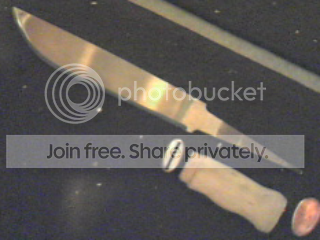

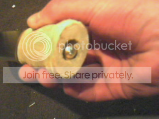

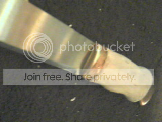

Well here are more pictures, just need to clean it up inside, polish up the blade and epoxy it all together. ive only epoxy'ed 2 other blades and i used a thin stick to get the epoxy deep down.. not sure if that has been what is needed to help prevent air pockets? anyway, here are the pictures

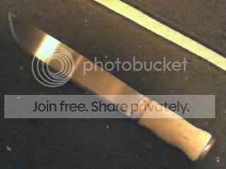

With butt cap
Close up of butt cap
Close up of recessed pommel
Not sure if it is visible in the low quality pictures i have but the ferrule and butt cap are different shades.. Im not sure if they are both technically brass or one is bronze? but i dont mind it much they both feel good and look good in my eye! just to finish it up.
Brass is copper and zinc, bronce is copper and tin, but the percentages may be different from one piece to an other. That may be the reason of the colour difference.
I can't realy see, how did you end up making the pommel? Is there a washer under the end piece?
I also use thin sticks to get the epoxy in the handle material, but I also put a good layer on the tang itself and then put them together.
Well here are a few pictures showing them, the ferrule and pommel are both more gold in appearance where the butt cap is a deeper brown, also, ignore the black marks thats just soot where i was fitting haha.
Heres the flip-side
