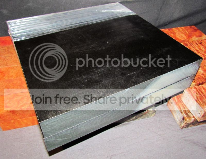

A couple weeks ago one of my regular customers called me and pointed out a plastics manufacturer selling black paper based phenolics.
Similar to Westinghouse's paper mycarta. Mycarta being a trademarked name, the manufacturer is calling it paper based phenolic.
I have always been anti-manmade handle materials because I am a prejudiced bigot calling it fakey looking plastic stuff.
Not really, but it is in my job description. OK, enough nonsensical rambling.
I bought some 1&1/2" thick black paper slabs thinking to use it for ferrule material on kitchen knives and possibly full hidden tang handle blocks.
I had searched knife suppliers and only saw scale thickness pieces for sale. In hindsight, maybe there is a good reason for that.
My questions;
Is there any demand/need for thick stuff like this?
Is it a durable material that will hold up under hard use?
What sort of blade should I use on my bandsaw to cut it with?
Am I a dummy who now owns some heavy black slabs of fakey looking plastic stuff?
Input from those of you who have hands on experience using paper based phenolics or paper mycarta is greatly appreciated.
I am not trying to sell this. I probably won't be able to do anything with it for a few months anyways. I am just checking to see if my customer advising me to get this, may have been a case of the blind leading the blind.
Maybe I could use it to make chopsticks, drawer handles or the big plugs those body piercing guys put in their ears.
It is really heavy. Works great as a door stop.

In my experiences, paper phenolic is much tougher than, most woods, but much less tough than linen or canvas phenolic. It tends to be more brittle, especially when drilling so go slow and have a "base board" such as wood underneath it. Other than that, when done right it looks great(I prefer a dull smooth look, or "carved") and is very functional. If you want supreme toughness go with linen or canvas phenolic, or G10.
Oh, almost forgot, I buy sizes like this often(get more for my money most of the time), and I just cut it into scales myself.
Dave, .....or anyone
What do I cut it with?
Will bi-metal wood blades work or should I use metal cutting blades?
I've cut it with a bimetal wood blade, but never in a production capacity like you might need. So there might be a better method in that circumstance. I've also cut it with a table saw.
I have used both, they both work, the bi metal seems to cut a little better though. If you cut the tougher stuff, use bi-metal, but in some cases even those will wear out quick. I just cut up the toughest Canvas micarta I have ever encountered yesterday, it was 2 5"x12"x 3/8" and it used up two brand new blades cutting it into 2.5"x12" sections.
Use metal cutting blades as the resin is pretty tough. I had to use hack saws on the stuff I had (paper, linen and canvas) as my wood and coping saws would tend to chip it and get dull. Treat it as you would metal, cut slow. Making other things out of it would be cool but I would stay away from the ear plugs just because of the type of resin used in the mycarta.

Paper based stuff "burns" easily at the point of contact when grinding, you have to use fresh belts when working it and I imagine the same applies to blades. Also, it looks different from the edge than the face even when finished. With thick blocks like that you might want to resaw them thinner at some point. Maybe cut it into smaller chunks that are short enough to fit through the saw nicely upright without flexing the blade. Who knows, maybe the edge on look will be cool instead, I'd try it before doing a bunch of cutting.
That could be interesting! Mark - when you do get around to cutting these up you should try that out. I've only played with canvas, burlap and G10 and have really liked working with them (except the smell, even through the repirator...).
I agree with most of the above. Phenolics and G10 just tear up wood blades in my experience. If I had to resaw or block up a slab like that, I'd start with fresh bi-metal blades on the fastest pulley setting of my metal bandsaw. An aggressive blade like a 6 or 8 tooth per inch.
