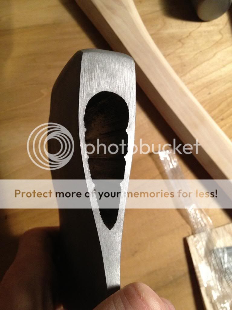

So I have a no name Connecticut that has the "Kelly" (I know some other manufacturers used them as well) type ridges inside the eye. Just wondering the best way to hang something like this.
Do I work the haft down till it goes in kind of easy, then use the wedge to establish contact with the ridges?
Or do I bang the head on so that the ridges cut into the haft as it gets seated?
Or is there a third option?

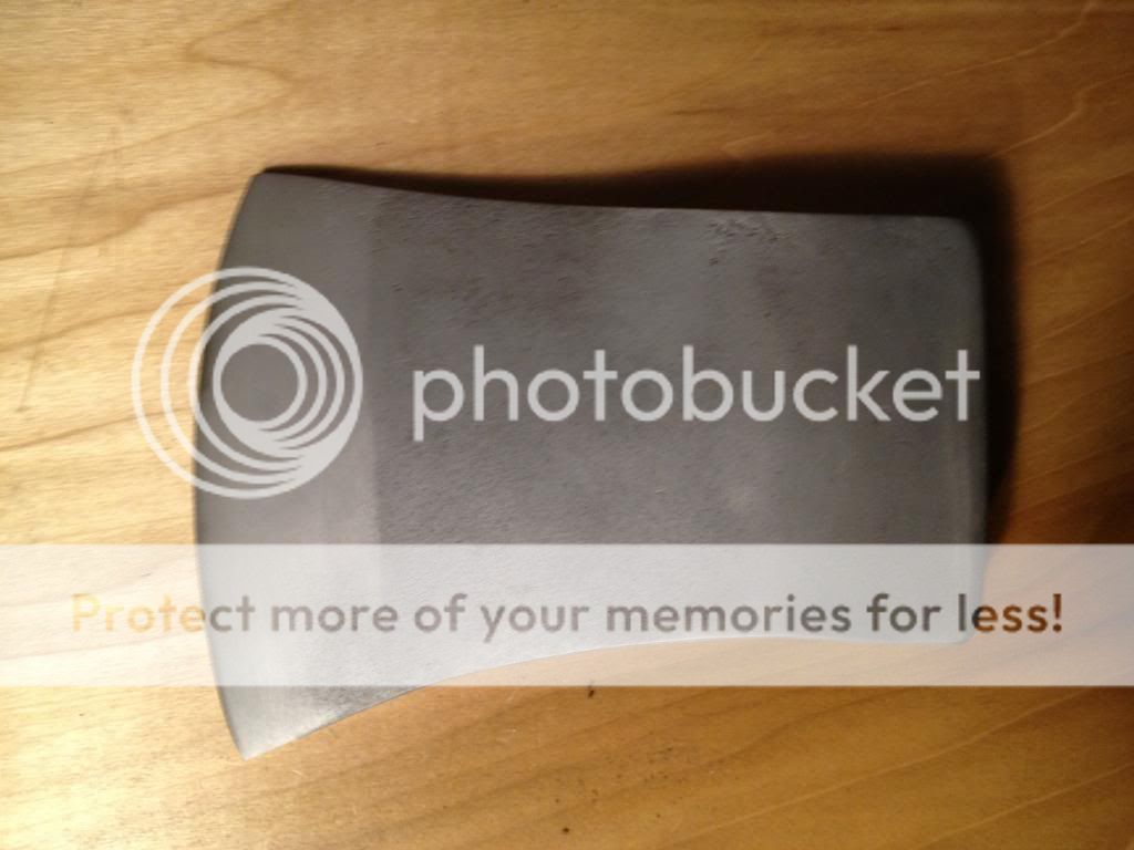

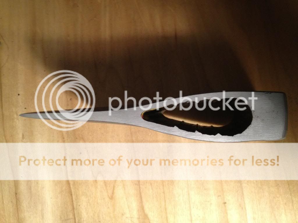

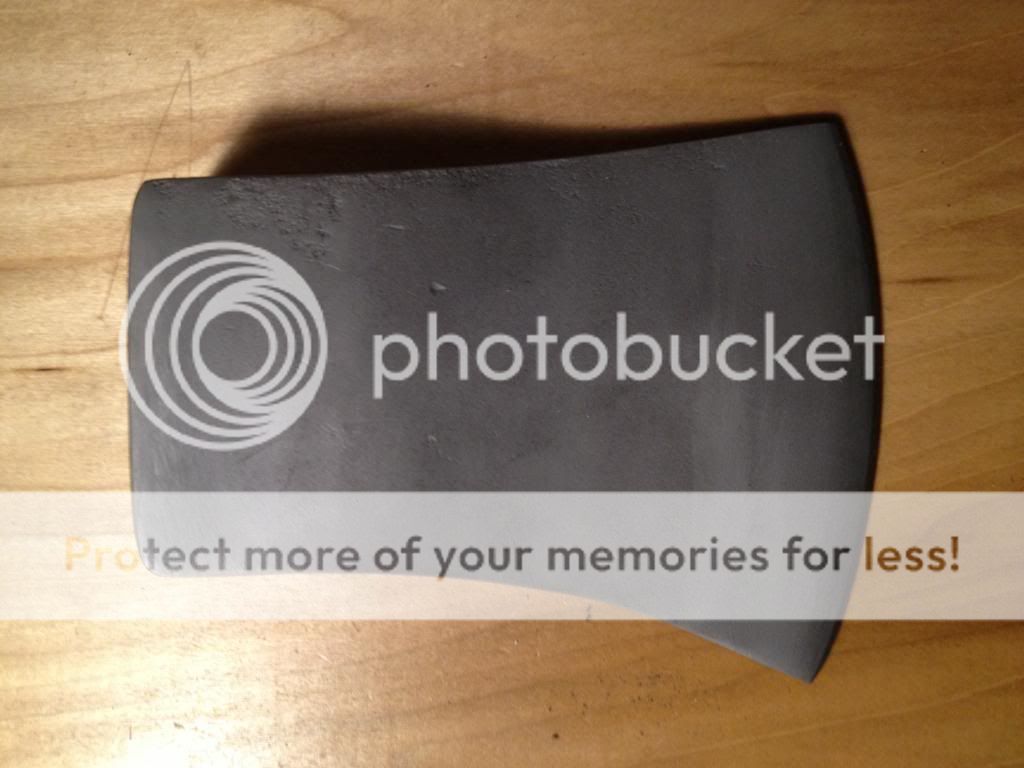

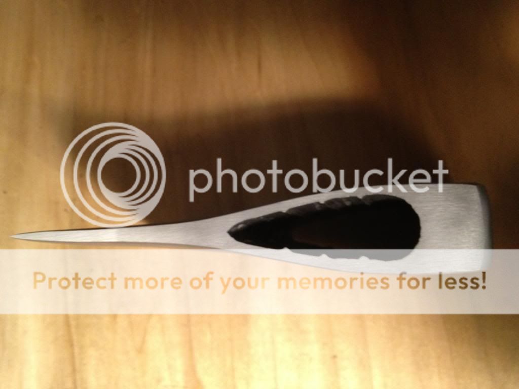

Some photos below of the head, before and after, since this will likely morph into a WIP thread. I am playing with various finishes. For this unmarked axe, there wasn't anything really to save, so I went with sandblasting followed by a good coat of oil. Looks interesting. You can see the hardening line due to the different rates of abrasion.
