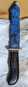

Here's what I have so far. I don't like the look. It feels solid and secure, though.
Anyone have any fashion advice?
Let's try again....
I think I will remove it and start over but I still want to shape it better in order to learn.
It looks awful, doesn't it...?

The handle seems to be at an upward angle to the spine line. It looks and feels better when it is even or curving down from the spine line.
I also don't like the look of the big bulge in the palm. Half that bulge would have been plenty of palm swell.
Yes! Actionable feedback!
I'll try to adjust per your advice. Thanks yet again, Stacy.
By the time I've sanded off those sections, the handle will probably be too small. Still, good learning opportunity.
With it already installed, there isn't much you can do besides reduce the palm swell a bit.
If it wasn't installed, you could sand the end at a slight angle (replacing the stacked liner material) and drop the butt. You might have to angle the hole in the tang or bend the tang a tad, too.
The scales/block was actually installed nice and perpendicular to the brass guard. The upslope is from me sanding down the handle at the front.
