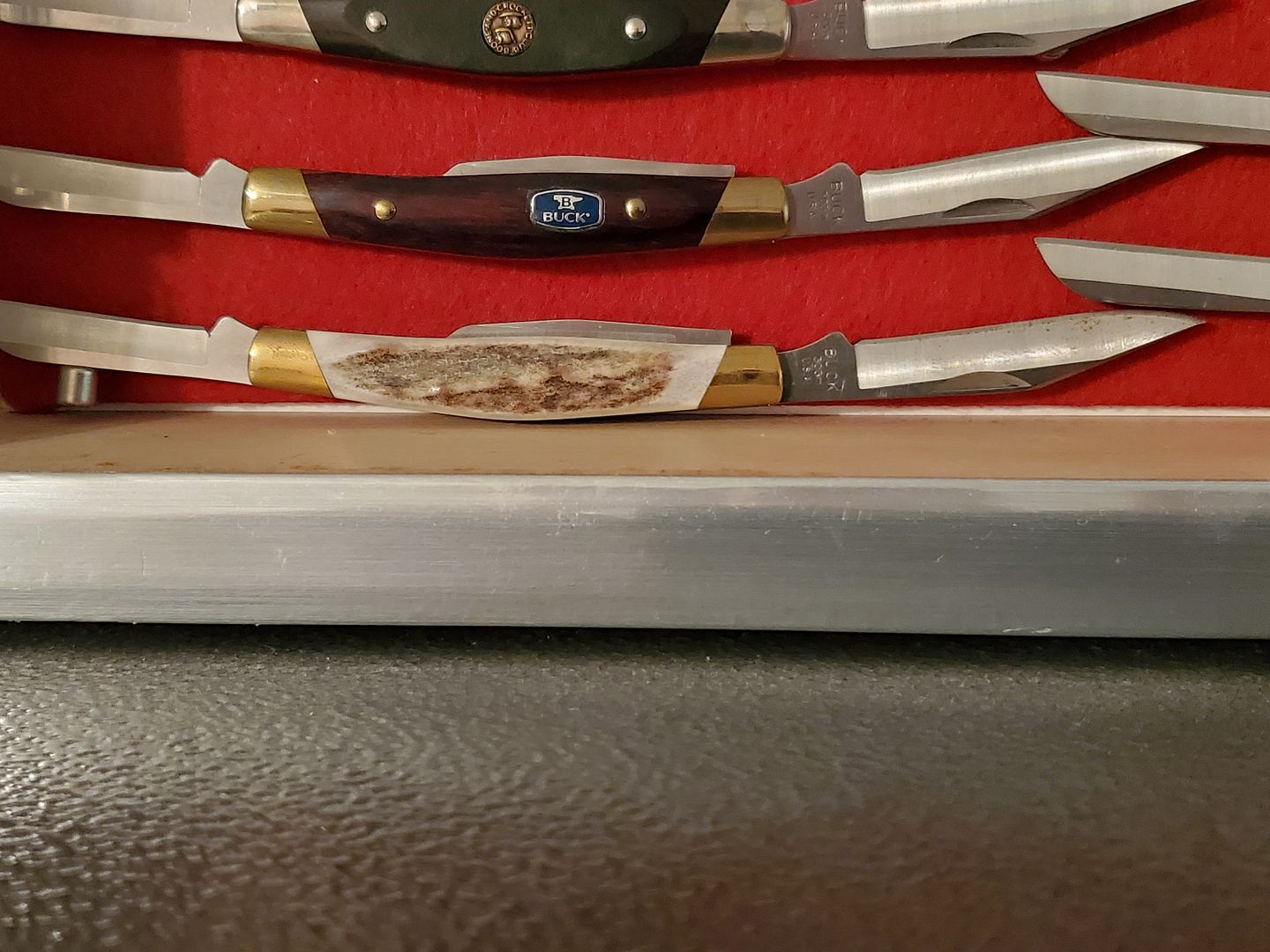

Magnets...
I took the Buck counter display and added a piece of tin furnace duct with red felt covering and glued it over the tracking. Then small barrel magnets to hold the knives in place.
I dont have the missionary knives. I got rid of most of the advertising 303s I had and concentrated on retail available factory models with a few exceptions.

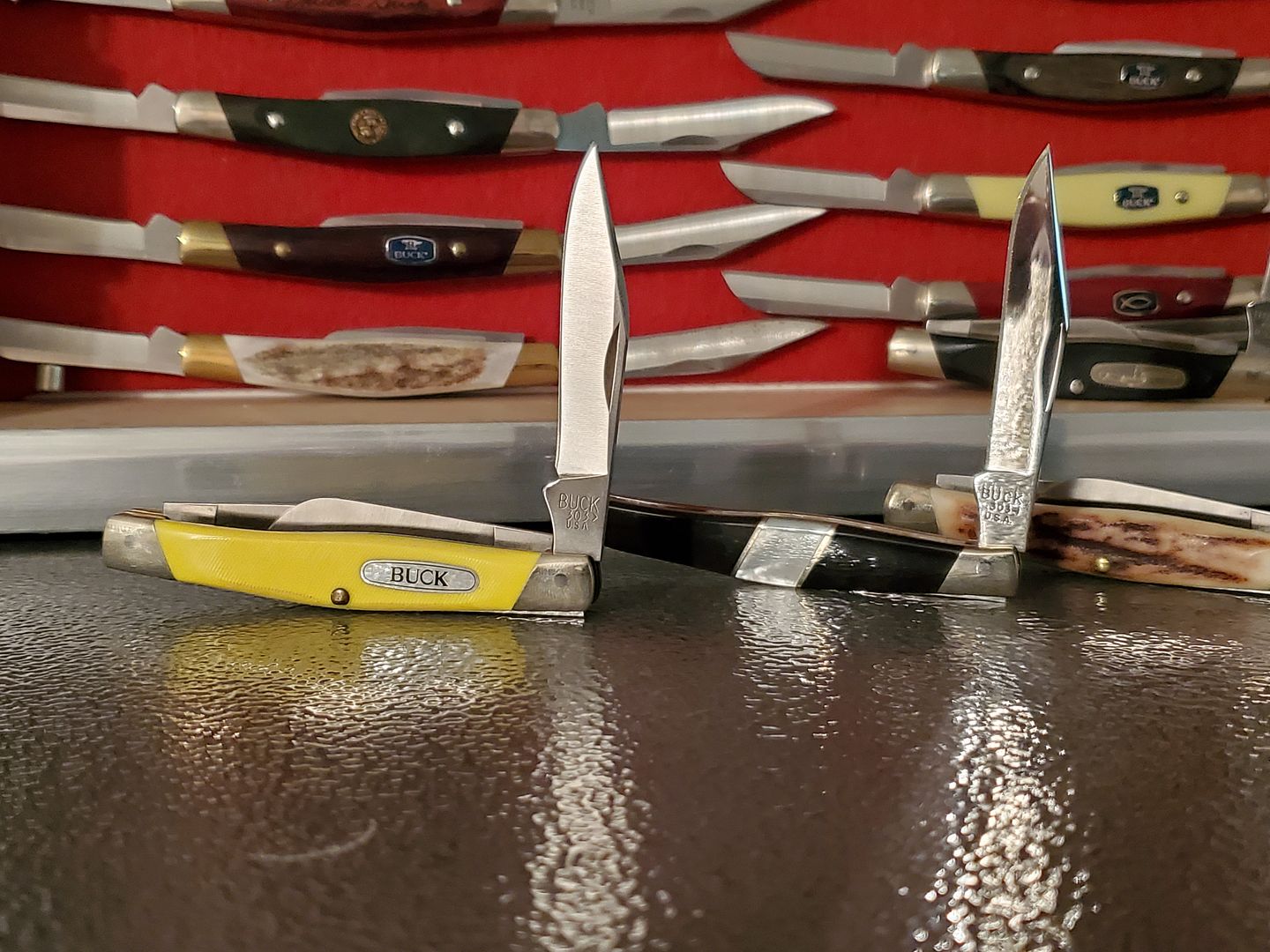

Custom shop stag on a Camillus
Single blade LE
Ironwood Timberlake
And some others...
