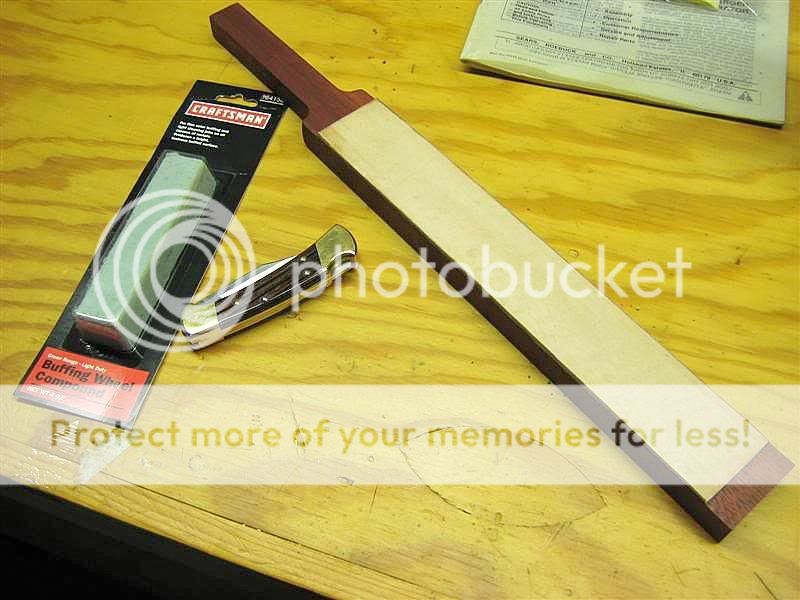

I was fortunate enough to receive a free strop from mr2blue, and thought I give my brief thoughts. Today's victim was an almost-new Buck 112. Love the 112, btw.

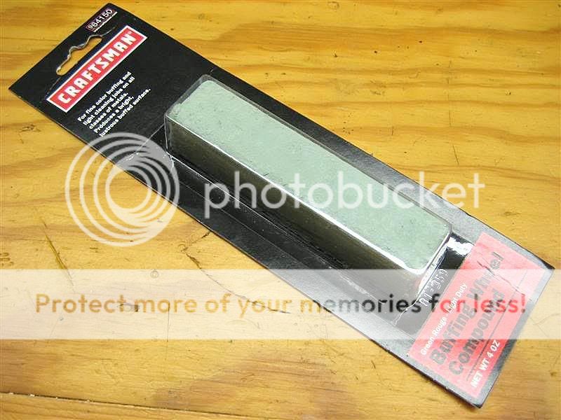

Pretty straight forward. First thing was to grab some green buffing compound from Sears for $2.19. Opinions vary on the compound selection, but there seems to be a general consensus that you can't go wrong with the green flavor:

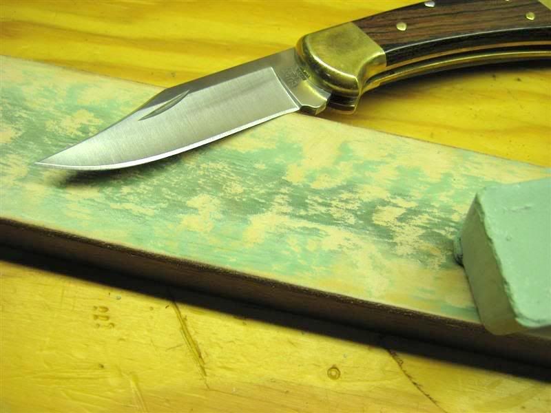

Colored it on the strop like using a crayon, and gave the 112 a few light passes, trying to keep the angle right. The knife was pretty sharp to begin with, having come that way out of the box and been given a few licks on a DMT extra-fine dia-sharp.
There is no doubt that the stropping polished up the edge a bit. The good old back of the arm shaving test demonstrated a real improvement. Note how the compound is not evenly displaced on the leather, indicating micro hills and valleys. It feels flat as glass to the touch, and I suspect that any natural irregularities in the cow hide will flatten out over time. [Edit: Mr2blue indicates that these very small natural irregularies will smooth out over time]. Might need to go a little heavier on the compound. In any event, it seemed not to affect performance, and I am very happy to now have the means of taking sharpness to the next level.
Mr2blue noted that the latest strops have beveled edges, which my early model does not.
