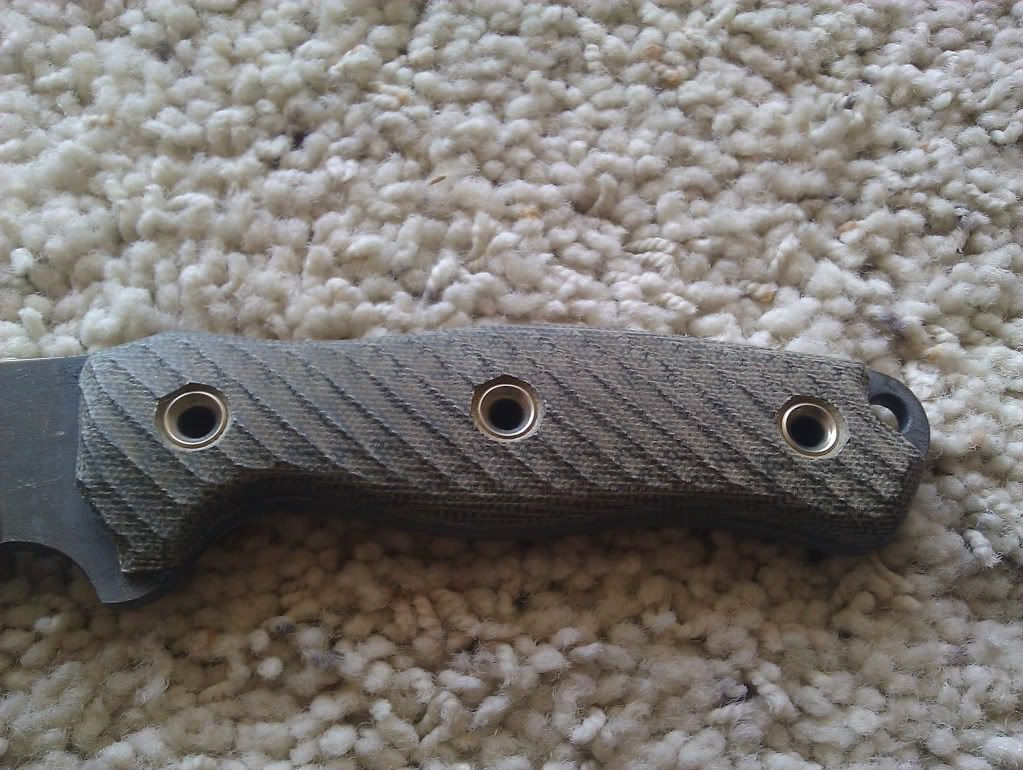

Just so people know, the stripper took the color out of the first layer of the micarta scales. I'm sure it will return when my oily fingers use it a bunch, it was just unexpected. Now I know, in the future, to use a little more precision.

That surprises me too. How did it look, though? Cool? Ugly? What color Micarta was it, and what did it end up looking like?
Just curious 'cause I know black canvas Micarta has layers of canvas that look a kind of greenish gray, same as tan and its pale yellows and brick reds. I wonder which of those is the color that gets removed.
No, it didn't look cool. I was actually pretty disappointed, but the color finally came back for the most part. I rub my fingers over it a bunch and it settled back in. It seems that it took the epoxy out of the first layer and left the off-white canvas look, so it turned it almost desert tan when it was originally gray.

At your request:
Before:
After:
I would liken it to this: If before it looked "wet", It now looks "dry".
Like I said before, the color came back for the most part, but for a while there I thought I really screwed up my knife.
If the color returned by you touching/holding the knife, then perhaps the stripper didn't actually change the color of the scales. I think it just dried the oils and residue that were within the pores of the scales (i.e. sweat, body oil, lub, etc) giving it them the appearance of being altered. Once you got some more body oil on there it matched the other areas that still had oil, sweat, lub on it.
It hasn't fully returned yet. I was thinking that only the first layer changed and by getting wet, or in this case having oil rub off on it, that it took on a darker look. When I first removed the stripper the color was a slightly brown, dried look. Either way, I'm not worried about it. I was in the beginning because I thought I trashed the color, but I'm good with it. Plus the stripping is coming along great, and I'm really liking the look; not to mention what it will do for me when I'm using it.

It'll come back, just oil it up... skin oil, lard, butter, or anything else you have available to apply to the handle will take it back to the way it was before, if not darker. Micarta & G10 all do the same thing with exposure to chemicals that remove the oils on the outermost layer, but it isn't a permanent effect, just like staying clean after you take a shower. If you over do it, clean it off with carb cleaner and start over, but they will get darker from use anyway, especially if you are sweating.
