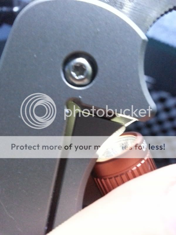

Here is a picture of my sage illustrating the problem. My old sage was not like this. It was in perfect contact since the two surfaces are perfectly parallel. Most people wouldn't complain about this. Like I said the lockrock comes and goes. But inconsistency is another thing that irks me. I wouldn't expect Spyderco to address this or even consider this to be a problem. The gap tapers down to a very fine area, more so than can be seen in the picture. So only that line of titanium on the lockbar will ever come in contact with the blade tang. Less contact = considerably less life span and stickiness. Every sticky lock I've ever inspected has had this tapered gap. Every one thats been perfectly parallel does not ever wear and never develops lock-rock. Just my $0.02.

I don't know the reasons for your lock-rock, but that contact point is designed correctly.

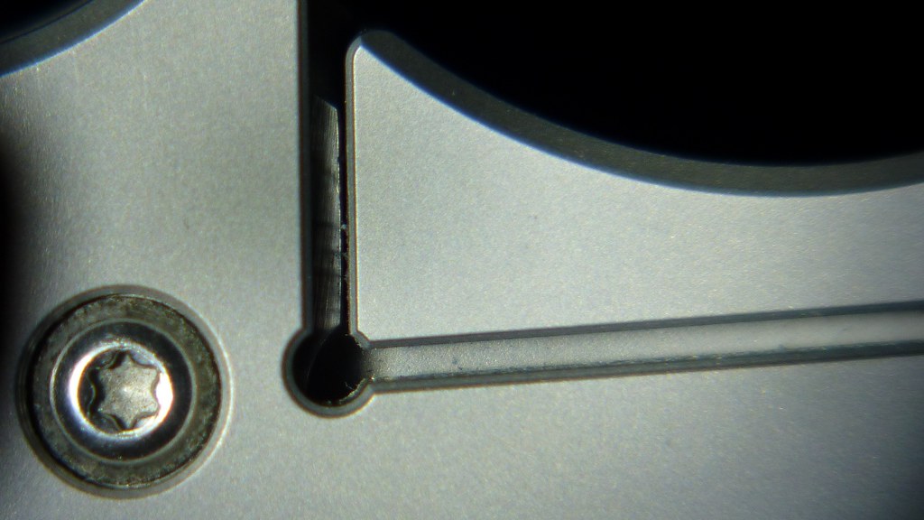

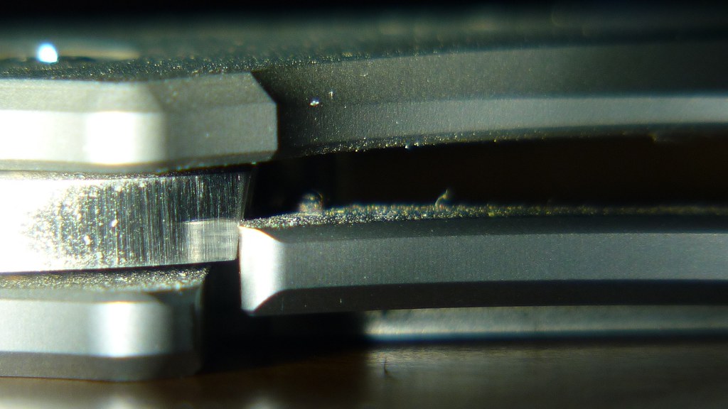

Here is my Sage. It has been used for about 8 months. Never hard use, but it's been opened a lot. I tried to get a picture of the gap between the lock bar and tang but there is NONE at all. The lockup is 100% solid and it doesn't stick at all. The contact is 100% as evidenced by the wear mark on the tang. I know that it should only touch at the far side of the lock bar for strength, but I think mine is perfect. The lockup has not changed at all since new. I hope these pictures help a little.
Also, I have seen another person with a Sage like yours. He complained of rapid lockup change. If it was mine, I would prefer it just like mine!
Thank you for the great pictures. That is exactly what I'm talking about. That's how my old sage was. It had full contact, maybe even from day one. In my mind that seems like it would out last one with a slight gap, whether or not it's the traditional way of doing things... I can't say, but I'd rather have one like yours.
