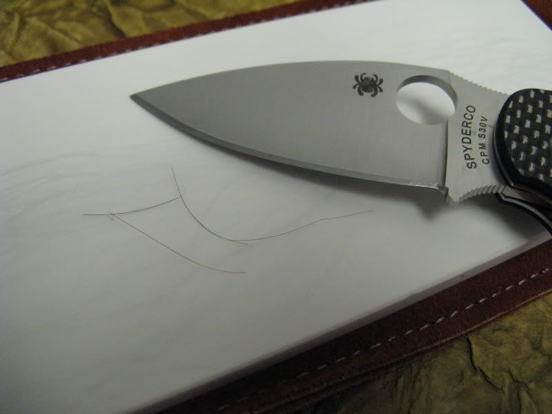

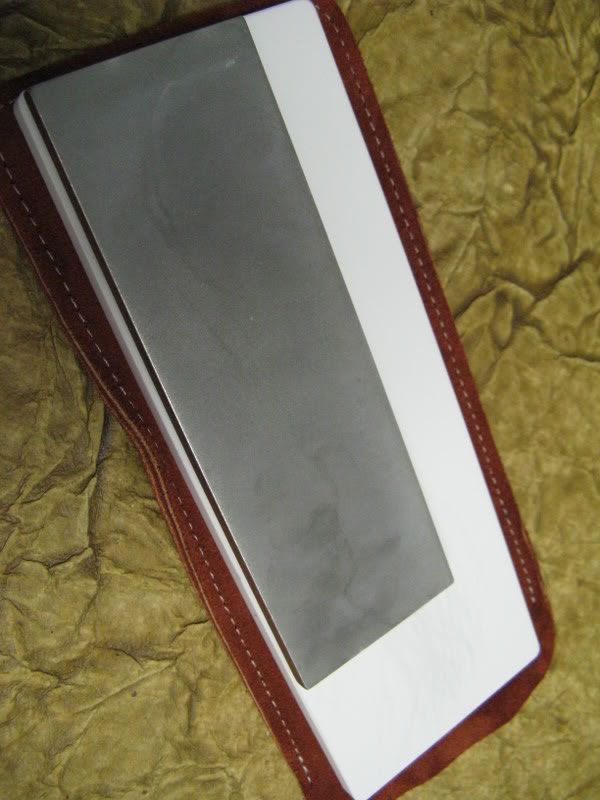

This thing is HUGE! :D
I was thinking of getting the UF rods for my sharpmaker for quick touch ups, but I only really use the flat part. SO... I thought this would be a better choice for me. Boy I was right! I always keep my edges nice, so this is for daily up keep on my EDC (what ever it my be :D)
Next to a Dia-Sharp......... Its a beast!

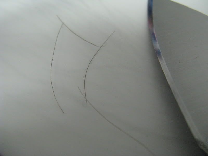

This Sage would shave, but not pop hairs and not whittle hair. About 20 swipes and she is back up to snuff. :cool:
I can not get this stone to tree top.... yet. :D Like my 6000 grit tape on the edge pro, but its a lot less set up time and is still "sharp enough" for most all EDC stuff.
Well worth the cost, as always with Spyderco ;)
