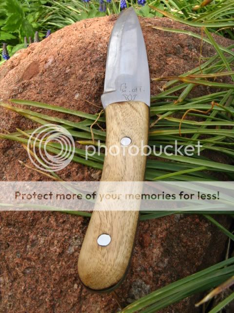

Hmmm better sell some of my other knives then! I was looking at some of the Khuks already! Have any pics of your R 10?
Here is the stock pic of mine. It has a patina now and the scales were stained and then linseed oiled.
I think it's Mercedes spring steel just like the kukris, and like the kukris, they kind of ruin the outer layer of the temper when they buff it. Once you file/grind down through the thin outer layer and get to the hard stuff, it's very hard and according to everything I've cut with it (including myself), it is, indeed, wicked sharp.
One thing that the picture does not show, however, is they are thick blades. Mine is over 1/4" thick at the spine near the scales. It does have a pretty good distal taper and comes to a decent point, however. Despite it's thickness and weight, it balances extremely well, the balance point being right at my index finger, and it drills into hardwood much better than any thick knife I have, and nearly as well as my BRKT Aurora, or puukko.
Mine looks the same, but with buffalo horn scales. Thikness near the spine is a little less than on the aforementioned example. The steel is great taking and holding a shaving sharp edge. The point is well defined and strong. I dont think anything done by the Kami's in buffibg the blade has had any effect whatsoever on the temper or hardness of the blade. Overall the knife performs way better than on would think at bushcraft work given the thicness of the spine. However being forged it thins right down and legthens out from there. Mine also balances at the forefinger and moves very quickly in the hand.
Good review once again Cpl. Its a great knife, I put a patina on mine as well, came out looking good IMHO.

Well, that is a great looking blade, H2OCutter! What is the sheath like? And did you stain the handle too?
Here is the sheath that came with it. I'm going to have one made for it thats ' more suited to her, and as far as the handle goes that is purty much the way she came, I used some 0000 steel wool and some clear poly oil finish to spruce her up a bit.
