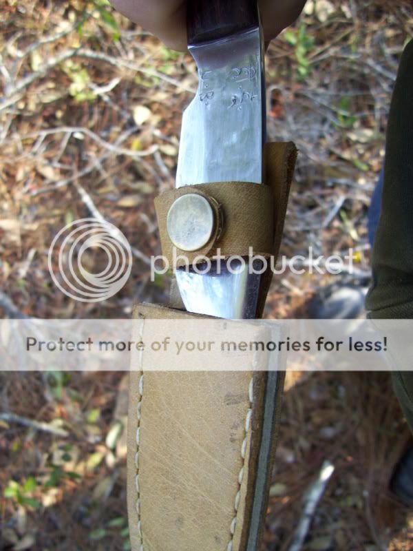

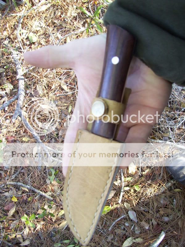

The sheath is standard fare for small HI knives. Retention is OK. The strap, well, there's good news and bad news on the strap.
The bad news is the snap is so tight you need a crowbar and two friends to open it. The good news is it really does nothing to retain the knife anyway. :p
