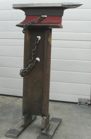

I milled the top of mine when I made it. The top surface is very hard on the cutter and it took quite a while but it did work. I then milled the edges flat and shaped the horn with a grinder. Then I sanded it all out and polished it. To add some mass I welded it to another section of track, then slapped some paint on it.
About 3 weeks after I did all that, I found an anvil locally for 25 bucks :mad:

That is freaking cool!!!!!
Thanks for the info all. A friend gave me the piece of rail I am looking to use. Its about a foot long. I wanted a "real" anvil but boy are they expensive. Old World Anvil's sell a small 4X4X4 anvil for 80 Bucks....but it looks like it would jump around as bad or worse than the Rail would. I spent part of the day lookin for an old bent forklift fork to use....but no luck there either. I'll look to use some of the info you have given to improve my rail.....and keep my eyes open too!
And the polished rail.....it looks too cool to use!!!!!
