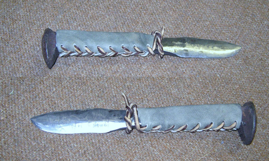

He's a member here
This was one that he made for me!!! Awesome little knife and it gets wicked sharp! He's a real stand up guy too:thumbup:
he does alot of beautiful work, and one day i'm gonna have one of his patch knives:D or maybe a hawk:D

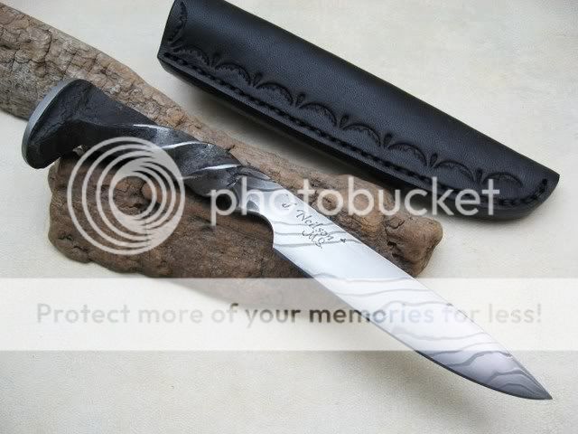

J. Neilson made a nice looking railroad spike knife with a twist damascus blade...

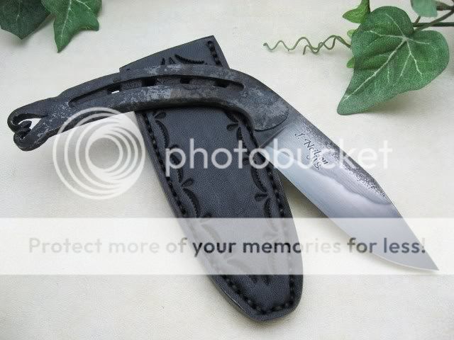

How about a horseshoe lnife...

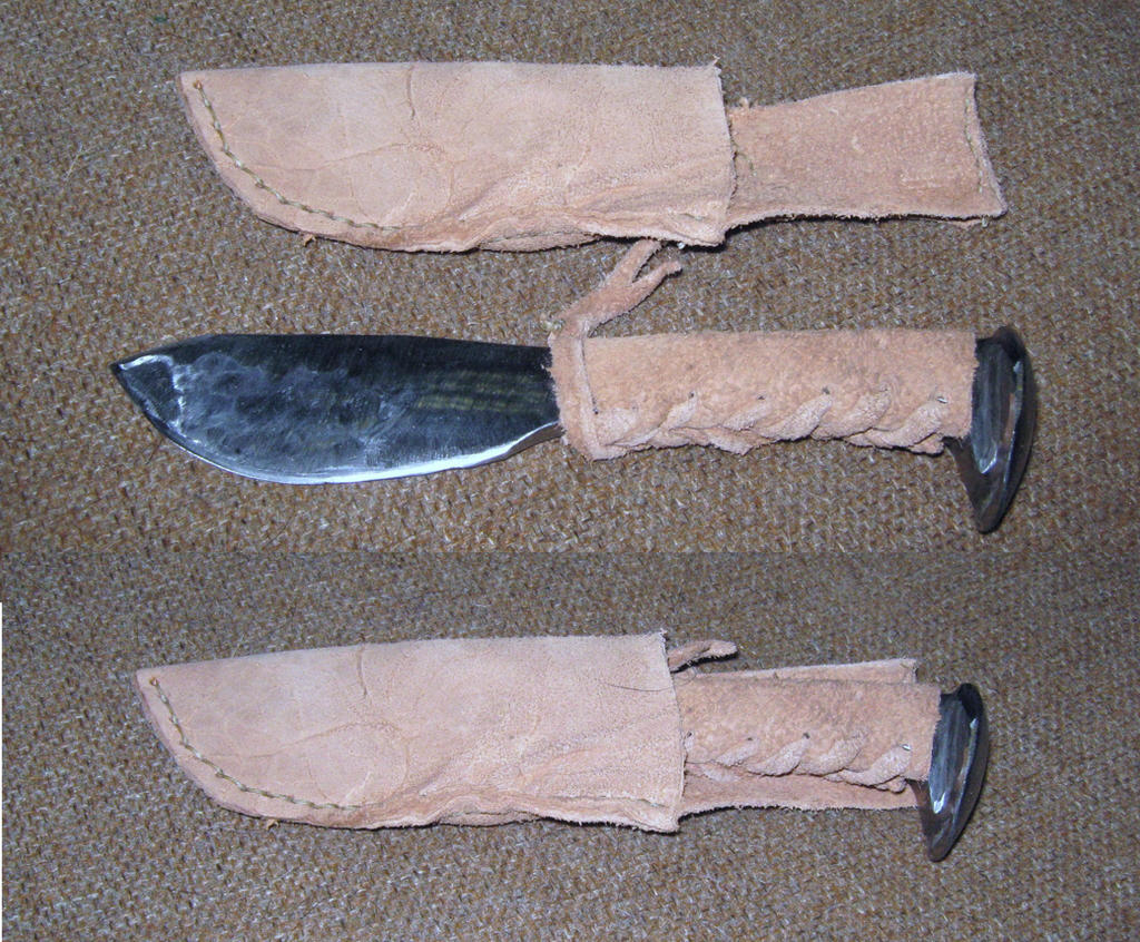

Here is mine
