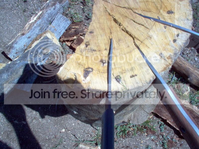

i have the rat 3 in d2. very nice knife. fit and finish are good. i took it camping a few weeks ago, along with some others.
i threw it, batoned it, and did a little food prep. when i batoned it into a log, the blade deformed slightly. when it was removed, it returned to true. i was worried it might snap, but it took everything i had.
here's a pic, its on the left.
