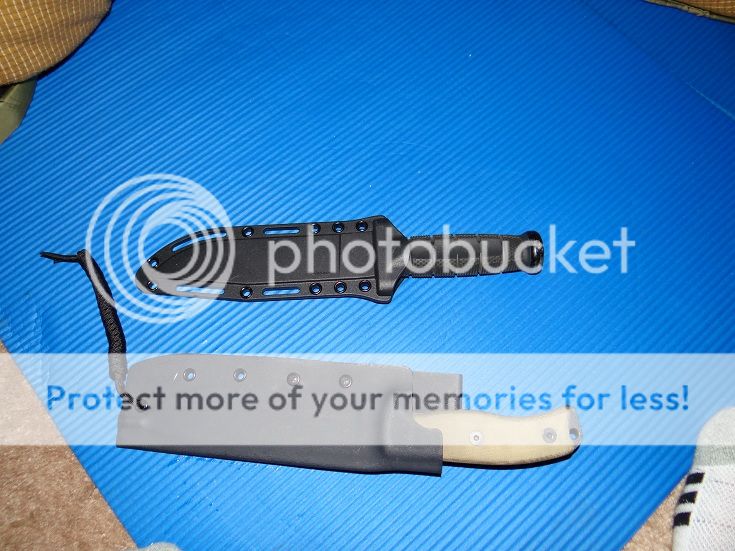

For a while now I have been searching for my perfect hiking blade. I have my Ontario SP50, which is the most amazing chopper and baton worthy blade ever. But it is too damn big. Then came the CS LEatherNeck, and for $50 I could never ask for more, but the Ergo's aren't the best, and I wanted something more baton worthy. Then I got the BlackBird, which is a great knife, but just not enough once I actually started using it in the field. So I went back to my CS LeatherNeck. And then I found the Rat 7 online, everyone who reviewed it had nothing but the best to say. So it seemed like a no brainer to get. Below is my comparison.

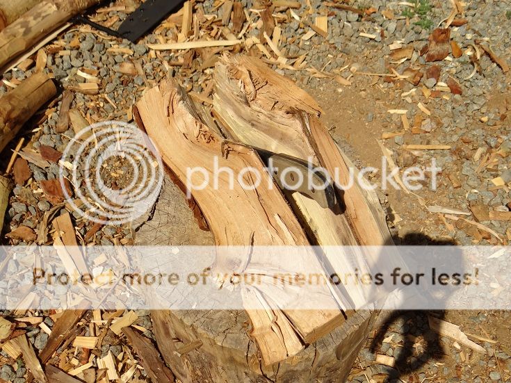

Then batoning, I was very suprised here. In every way both knives performed the same. I really thought the Rat 7 with it having way more steel would be better. It just wasn't, it bent as much or more on the batoning. It didn't mess up my baton as much, so plus one for that, but when the black bend with the knots, it makes it harder to baton, and it just didn't have more resistance than the LeatherNeck. But I will say Ergo's again and again won out, the Rat 7 had so much less shock.

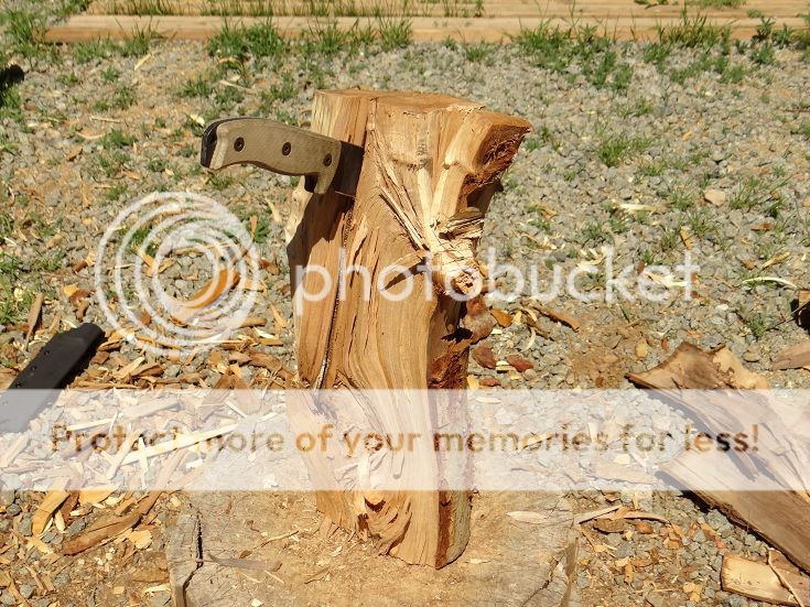

Finally came the tip test, last on my list. Here after a few short runs the tip broke on the LeatherNeck. I was stabbing deeper than I was with the Rat 7, so I got out my baton and hammered the tip of the Rat 7 as deep as the LeatherNeck, and did my tip test. And while the tip didn't break, it bent. I bent it back with the same stab hole I made(much better to use a hole in wood than a vise, trust me on this). I'm gonna call that a draw too.
