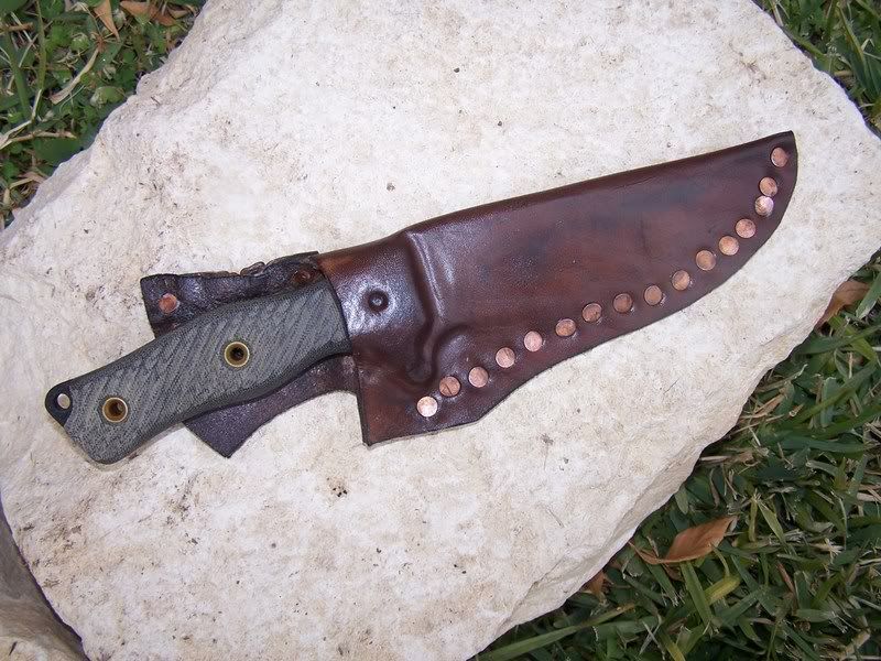

I put together a sheath for my new M6 following info I've gleaned from this site and numerous googlenet searches. I used rivets and just hammered them together; they look sorta crappy but it's my first go 'round. The sheath itself is wet molded and bees wax dipped. It grips the blade with authority! The next one I make I will attempt to stitch together, and also keep the melted bees wax off the kitchen floor.

Looks great! What did you use to melt the beeswax in? I picked up a cheap crocpot at wally world that works really well. I leave the wax in it covered with the lid, then just turn it on when I'm finishing another sheath.
I just used a non-stick baking pan and baked the wax at about 260 degrees. That was probably way too hot; the next one I make I'll go about 160-180 degrees. That way I won't burn the bejeezus out of my fingers and spill hot wax on my toes and floor.:D After the job, I just put the pan in the fridge and the wax shrank back up. I just snapped it into 4 peices and wrapped it in tin foil until the next job.

The following link was fairly useful. http://www.homestead.com/beknivessite2/pouchsheath.html
