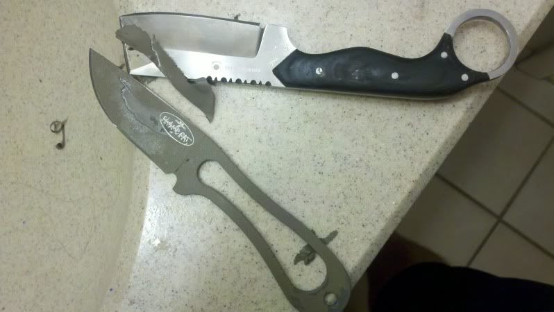

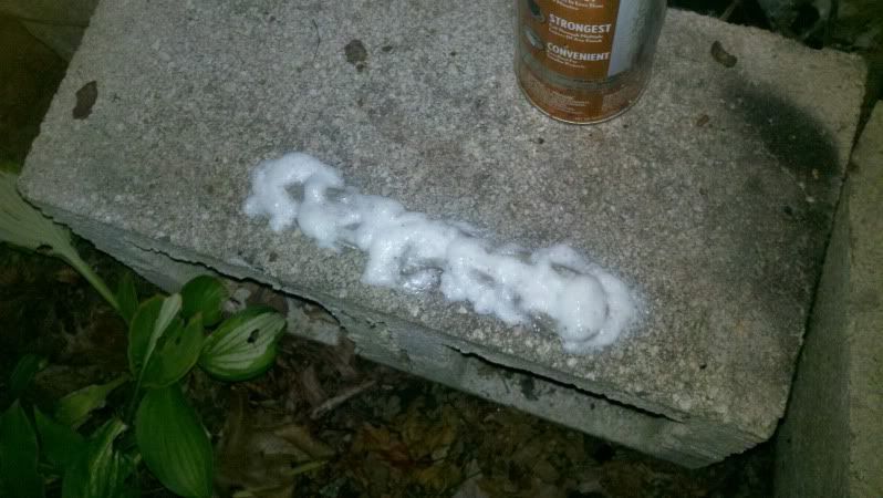

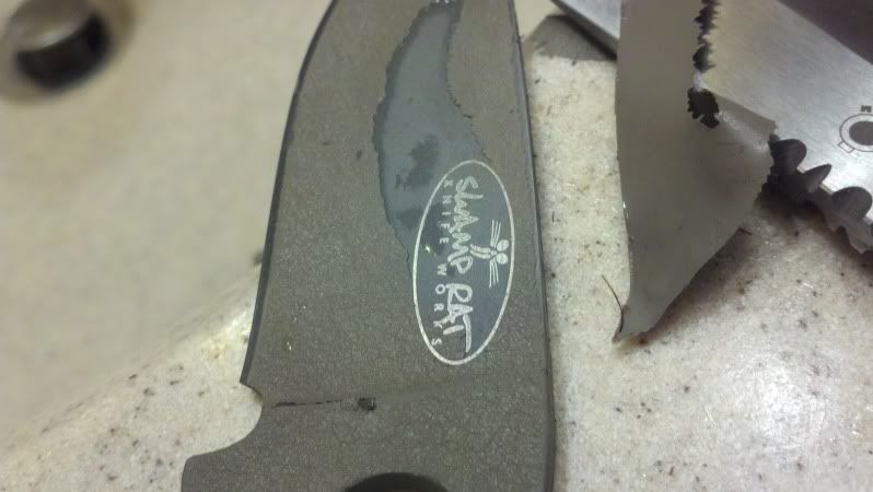

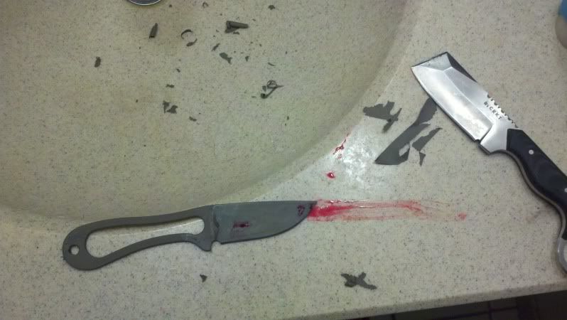

First I stripped it. This coating was TOUGH! as the stripper barely took it off. Never had this problem before.
It basically just loosened the coating. I had to scrape it off by hand.

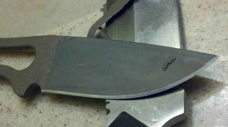

The Razel offered some help.

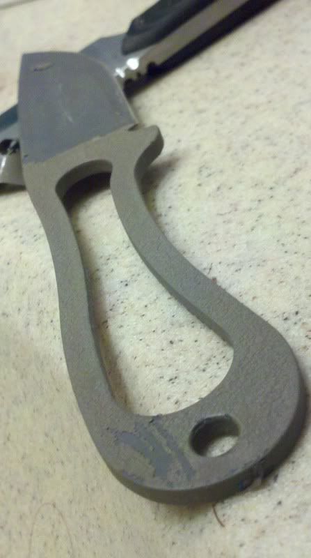

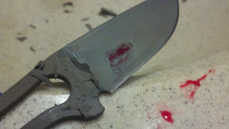

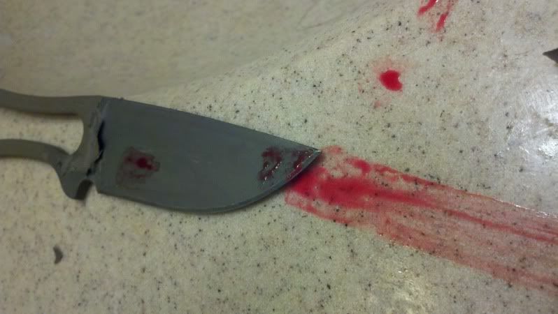

SR101 is smooth, but gray when unpolished

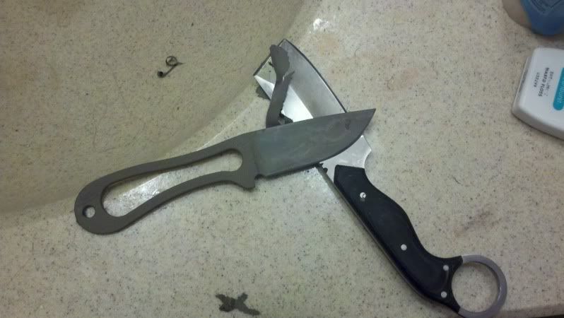

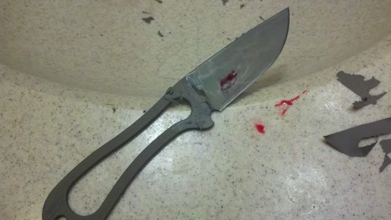

It bit me! Dont mess with a p!ssed off, naked rat. :D

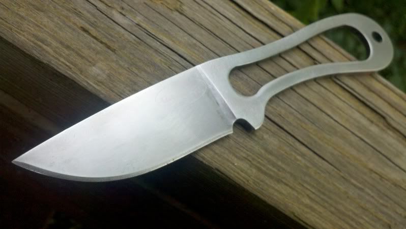

Here it is completely stripped and only hand polished. Edges are still square

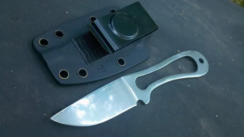

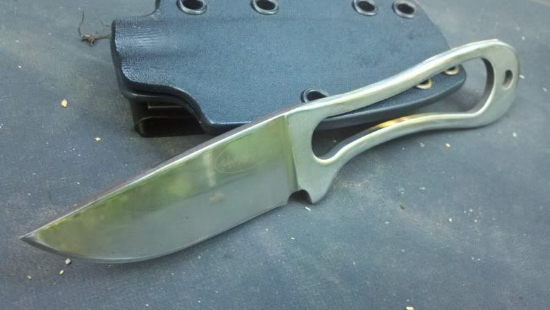

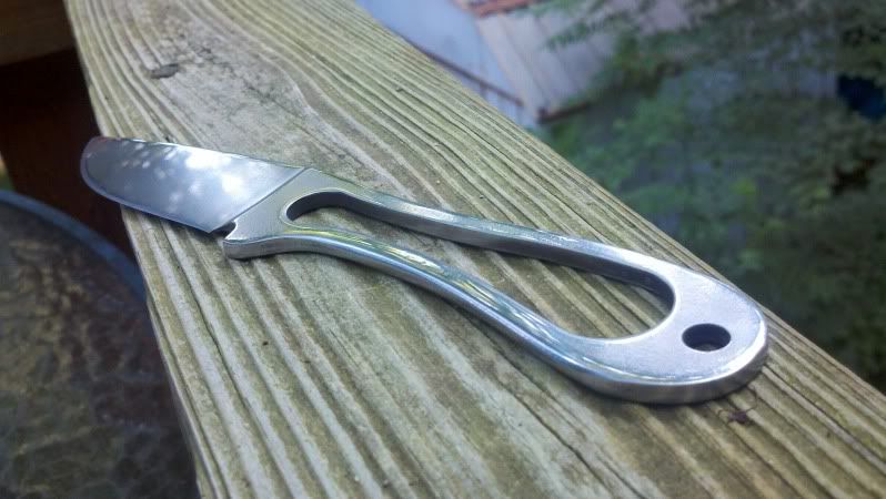

Here is the finished product. I used a sanding disk in a hand drill with adhesive backed sandpaper up to about 800 grit. I "melted" the upper and lower edges of the grip with 80 grit paper. You shoulda seen the sparks fly! Of course I cooled it off every minute in some water, never letting the blade get remotely hot.

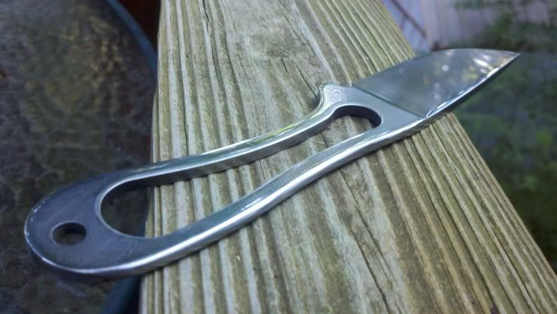

Melted upper edge, the butt end was left square for popping beer bottles. :D:thumbup:

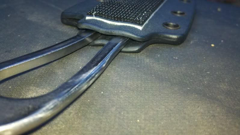

Melted lower edge and guard

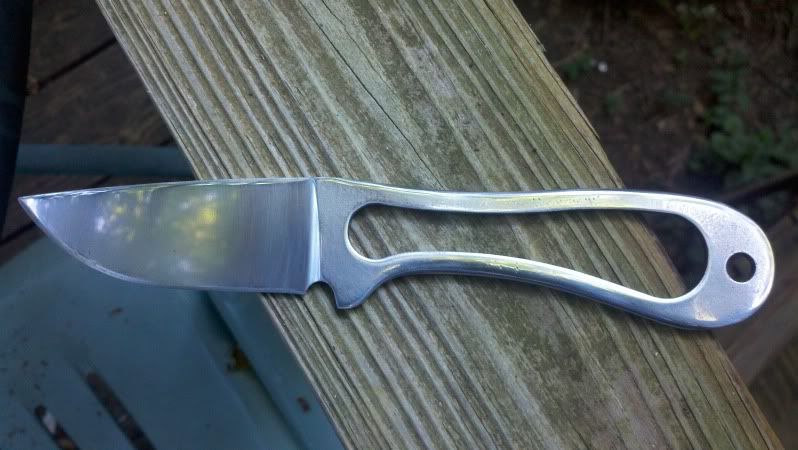

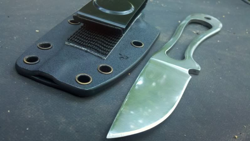

I hit the whole knife with wet sand paper: 1000, 1200, 1500 and 2000 grit. You can still see some dimples. Its not perfect

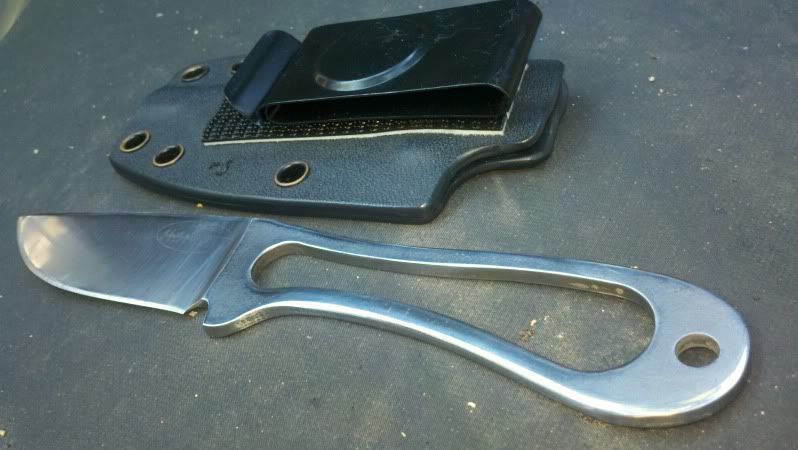

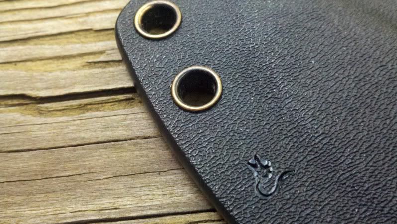

Now for the sheath: This idea was Steelnut's design (this isnt his sheath though, sorry Scott... it was a combo package) This is a strip of 3M's industrial "dual lock" with a belt clip from Knife Kits.com attached to a Mashed Cat.
You can pull of the clip (not easy) and adjust it how ever you want:
"Nice sheath Meow"

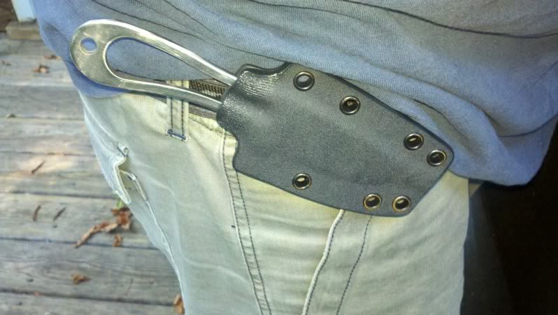

Can be worn vertical:
Or horizontal:
Or anywhere in between:
