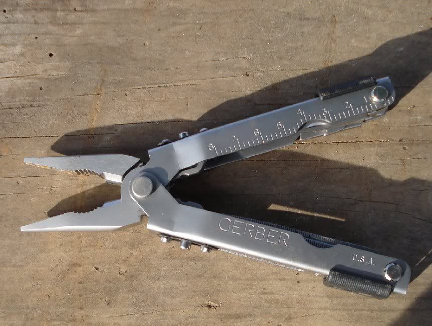

I've not previously given much thought to multi-tools. I've had this Gerber multi-tool in my truck for several years. I don't even know what model it is, but it's come in handy on occasion. I was wondering what others thought of it in terms of functionality and quality as compared to other tools on the market.
And if I were going to buy a new tool do any of them have cutters that are strong enough to cut chain-link fencing or hog wire?

Looks like an older Gerber MP600 series. Good tool.
If you were wanting to replace it and cutters are important, I would get a Leatherman Supertool 300.

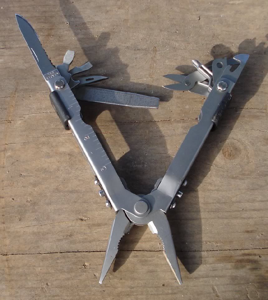

Ive got one just like it, only my Multipler 600 has a serrated sheepsfoot blade instead of the scissors. I used this tool everyday for 1 1/2 years at work.
It held up pretty much to anything i could throw at it. One time though i tried to cut a piece of stainless steel welding filler rod, unfortunately it was too thick and too hard so it damaged the cutters which were softer than the rod, but it still cut it though. Only minus with the Multipler 600 is that the cutters dosent come with a hardwire notch.
Quality was pretty good, nothing broke or got loose and everything performs as it should. Ive retired it now cos of the damaged cutters and carry a Swisstool X at work.
For serious cutting id recommend the Leatherman Supertool 300 with the replacable cutters.
