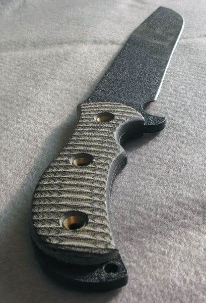

I recently red a review in progress at http://www.physics.mun.ca/~sstamp/knives/ratweiler.html. In this review ergonomics of the RW handle is discussed. The micarta scales are slightly lower than the blade which means that the top ramp digs into the palm when using an overhand grip. But when I examine pictures of the handle at http://www.swampshack.com/ the scales are totally covering the metal and no painful top ramp can be seen.
Are there any RW owners out there who have experienced this?
Leaving the metal of the tang exposed must be a pre production error of the early Ratweilers?
Sorry if this has already been discussed in this forum. I feel the need to get this explained because I have a RW on order.
i think you misread. cliff is saying when you choke up on the blade, the thumb ramp digs into your palm. it is never stated that the blade tang is above the micarta slabs. of all the swamp rats i have, they are ALL perfect in terms of fit and finish of the scales. the only thing to maybe complain about is the factory grind/edge. but it's a minor gripe, hit or miss, that can be changed by the user...
I really hope that I misread. But when I look at the last pictures in the review I think the micarta slabs look very small and the black tang is exposed more than one millimeter!

those pictures are far too small and grainy to make out any detail. The Tang does not protrude and make the knife uncomfortable. you are probably seeing the darker portion of the black canvas micarta where it is smoother near the tang.
Here is a pic of an Identical handle on my Rat Daddy:
He has a point, several of the pictures in the review make it look like the micarta slabs actually don't run flush with the grip, and are actually below it significantly. This is because of the very poor lighting conditions. I'll redo them tonight and fix it. Thanks for pointing that out. Here is a picture of a Ratweiler which doesn't look like it was taken by a retarded monkey :

The scales are flush, there are a few problems with the grip though :
1) That apex hump is problematic in overhand grips, it digs into the center of the palm. I don't see it being prominent enough to be useful security wise. The only use I have found for it is when I am out hacking up something with Patrick and he does something fairly annoying, which is often, it serves as a nice impact point to clout him in the head with, as I would not want to risk dulling the actual edge on his overly thick skull.
2) The section of the guard which faces the index finger cutout in the choil, is way too sharp, in particular the very end could be described as sharp. That should all be heavily radiused.

Hi HTL,
I totally understand your concern about that...that would be extremely uncomfortable and quite honestly a good reason to consider a different knife altogether. But, as the others have stated, the micarta scales are flush with both the top and bottom of the grip. The edges of the micarta tend to get very dark with use, usually because of the oils on hands or gloves. It makes it difficult to see the contours of the handles.

As far as the review, I tend to agree with some of the statements. For instance, I've also noticed that the "apex hump" is a bit wide and pushes against the palm, almost opening my grip while in a standard grip position. In this regard, I wish that the hump was made a bit smaller. However, I find that hump extremely comfortable when I choke back on the handle to take a larger swing. Dunno....might be a bit of a comprimise. I am still considering thinning this out a bit on my knife.
I have never really found the "sharp" area near the choil to be an issue, though I did reshape the backside of that prominence to reduce the distance between my fingers when choked up into the choil. I also like that this modification does not leave a radius toward the grip. A little jag there gives me added security that my hand will not slide down the length of the blade when stabbing downward or otherwise.
Here's a pic:
I've also flattened the rear exposure of the tang to provide a flat surface for hammering...there's nothing worse than beating your hand with a baton when it gets deflected off a round surface. ;)
I've never had any issue with the top spine ramp. Though, if it were any larger I would likely round it off with a file.
Yes, they are jet dark on mine and look just like the tang. I have annotated the reviews. I'll upload the updates shortly. Can I link to your picture in the above in the review to clearify the issue.
