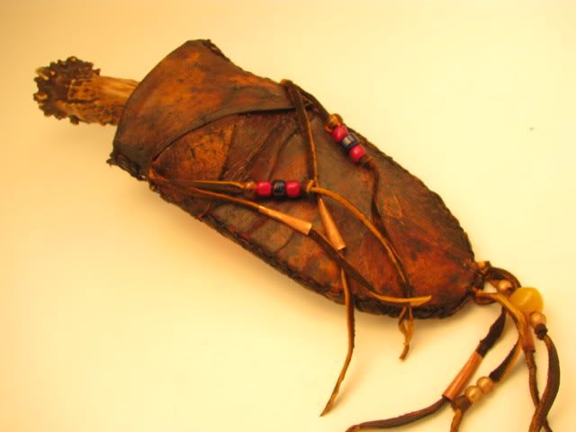

Following Mr. Cohea's tutorial I made this sheath. I'm very happy with the way it turned out. I used red heart glass beads, blue glass and amber glass beads, one larger piece of amber, and some brass beads with copper cones. I used ferric chloride on the copper cones and brass beads.

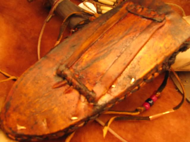

I didn't have the copper nails when I took those pictures but they are on the sheath now. I also added another layer of polyurethane and it is drying. Tomorrow I'll do the final sanding on it and get it delivered.
Thanks again,
SDS
Your welcome SDS. Your right, it took me a few years to figure it out to get my sheaths to look like they do now, and the whole purpose of the tutorial was to shorten the learning curve for anyone who might like to take a shot at it. If you would, post a couple of more shots before it goes out, and include a shot of the back, if possible.

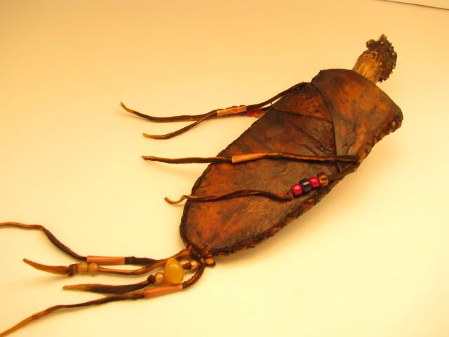

Still waiting on the last coat of finish to completely dry but here are the latest pictures. The buyer is picking it up tomorrow.
One question, did I do the copper nails correctly?
Thank you again for the help with this one. I'm constantly amazed at the generosity of people in the knife making world.
Suggestions and criticisms always welcomed.
SDS
You did fine SDS. The only thing I do different on the tacks is to clip the shanks and peen them, but what you did will work. The clipping and peening just maks it look a little neater.
