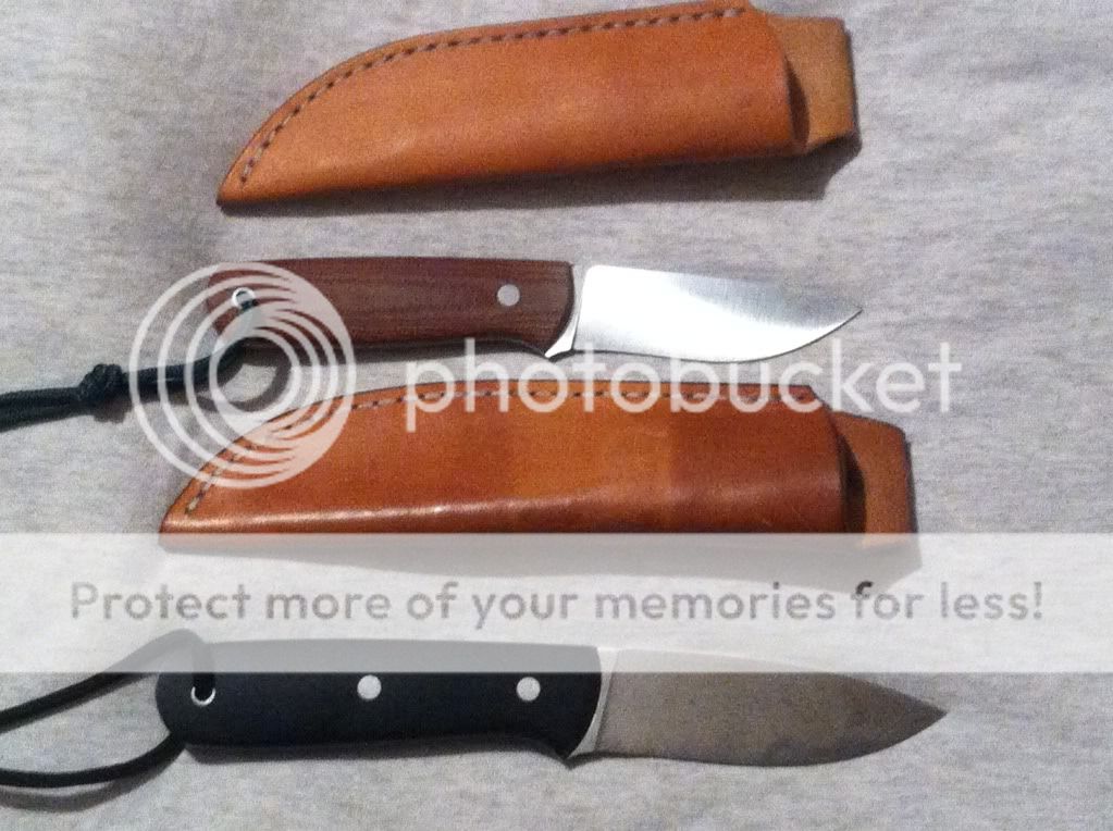

Specs:
Blade Length: 3.983
Edge Length: 3.860
Blade Width at spine: 0.123
Blade Height at Ricosso: 1.013
Blade at Belly: 1.025
Handle Length 4.700
Handle Height at Palm Swell 1.053
Handle Length from guard to butt point: 4.136
Handle thickness at palm swell: 0.836
Blade Steel:1095
Handle Material: Cocobolo
Handle Pins and tube: Stainless Steel.
Grind: High sabre - Flat Grind - Secondary bevel.
First Impressions:
I am a nit-picky bastard. I am the type to sit and sand, sharpen, and work out little things in knives for a few hours even before using them. Ray's work is some of the best I have seen. For the price, it is flatly the best I have seen. His grind lines are money. His double bevel was sharp, even, and perfect. The handle contours were well done and well finished. The pins are flush and the fit and finish is spectacular.
I did essentially nothing to this knife but sharpen it (this is just one of my rituals) and go use it.
In the Hand:
This knife is a really impressive blend of contoured blade and a neutral blade design. At times something like a dowel handled Mora can be a little too neutral in a hammer hold, and something very contoured (like a Bark River) can be uncomfortable in long use in anything but the hammer hold.
Ray does an awesome job of having a neutral enough grip to make the knife very comfortable in multiple positions yet contoured enough to make it comfortable in the hammer hold.
The knife is VERY nimble and extremely light feeling. The balance is in the middle of the first finger and thus has a great balance and feel to the knife. I was shocked about how light it felt.
A Little wood Time:
I was able to get the USPS man to give this to me right before I went into the woods this weekend. However, I had no sheath so I had to be happy simply using it around the fire.
I was worried that a double bevel knife (this is the only one I own) would not be as smooth with wood as a convex or be as hungry as a scandi. What I found, however, is that Ray's double bevel is money. I had no problem making fuzz sticks, carving wood, or batoning fatwood to get a fire going. In fact, what I loved about this knife is that the edge is so very robust that it does not even need to be touched up when some of my other knife might need to be.
The edge holding of the knife was superb (which tells me a lot about the heat treat) and after considerable work with soft and hard wood, I merely would have sheathed the knife instead of stropping it.
Conclusion for now:
I really enjoy Ray's knife. For the price it is phenominal - this one feels like a keeper. In fact, it will likely bump another knife out of my stable.
TF

I originally wrote the above review a little over two years ago. I have owned, sold, then bought back and used this knife extensively.
This is the ONLY knife I have ever re-bought. There is just something about it that I love. It is such a simple knife - simple in the best way possible. It has no frills - never will turn heads - but will ALWAYS perform for you. I have learned through making sheaths that simple... is really hard. Ray's grinds, and thoughts are so automatic - so robotic - that the knife just falls into your hand and becomes an extension of you without thinking about it.
The wood has never shifted - or become proud of the pins - or shrunken. It is like beautiful micarta or something - just awesome.
I love the very fine matte finish that was left on this flats as they really seem to keep rust and pitting away. The Laconico emblem is still as deep and legible as ever - after quite a bit of use.
The knife is a joy to sharpen (I use Japanese water stones while at home and a DC4 in the field) and it takes and holds an edge extremely well. I have learned to free hand sharpen with this knife and really enjoy the process. I have a 25 degree inclusive bevel on it - taken to 8000 grit and then stropped through three compounds to bare leather. It is a razor. I am spoiled by knives like these - and I simply do not keep knives that do not perform to this level.
It is the only double bevel non-scandi bushcraft knife I own - what can I say?
From what I can see of Ray's stuff - he has only gotten better. I wouldn't hesitate to own another one of his knives.
TF

anyway...this seems to be a long post that just was supposed to say, "Thanks for the review!" and thanks for the pics.

I'm curious Tal,.... Double bevel? I'm not to familiar with that description. Is that 'double bevel' as in double primary grind and no secondary? Does that refer to a full flat grind with no secondary as in a full convex grind?
Just curious.
Neat review by the way. I always enjoy your combinations of information and pictures.
THink of a bar of steel - flat and rectangular. The first large bevel would be the Flat Grind - then the second bevel would be the actual edge itself.
I have always heard this referred to as a double bevel knife. Maybe I am high.
Anyway - it is a High Sabre Flat Grind with a 25 degree bevel on it. Does that help?
TF

Thanks for the clarification. That does help,.... Maybe I was overthinking it.
Very nice! Mr Laconico makes some very nice looking knives and that one looks like it's really comfortable too.
Not to knit pick or anything, but if I am seeing the pictures right then the edge geometry is what I, and what I think most of us, call a very high saber grind with a secondary bevel. It's an edge geometry I'm really partial to myself due to their good slicing ability while maintaining a little more lateral strength than a full height flat grind because of the material left in the flat at the spine.
Thanks for sharing your thoughts. I agree, Ray makes good knives.
A couple of years back I had Ray make me a full custom, based on the Argentine criollo design. It's a full flat grind, with the very edge convexed. It's one of my favorites and it helped me realize that I don't much care if a blade is full flat, convex, or scandi grind. They all work if the knifemaker knows his craft. Obviously each geometry has its advantages, but they'll all serve me well in a general use knife.
Mist, I agree - I had corrected this two posts above yours - but fixed it in the original post.
I simply call ALL grinds that have a original grind (whether hollow, flat, or convex) that has a secondary bevel a 'double bevel knife'. Perhaps I should not do this as it is confusing.
Anyway - I fixed it in the original specs as to remove this confusion.
Thanks for the gentle correction.
