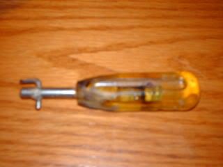

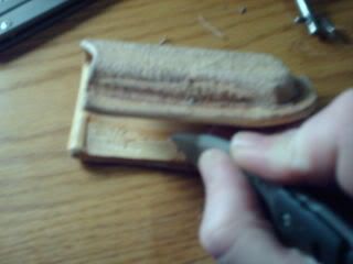

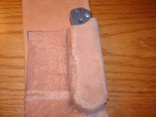

As I stated I didnt get pics of the forming so we are starting out after the wet forming. My shaper is just a 1/4 inch SS rod that i ground to a bullet shap and polished.

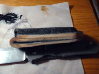

Pic showing Mr.Graley's method of folding and cutting the leather to keep from getting a crease.

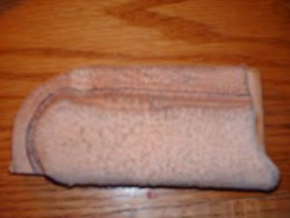

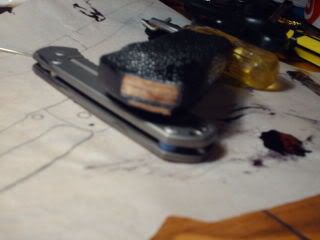

I decided since i was going to just glue the overlay i put the coarse side out to aid adhesion.

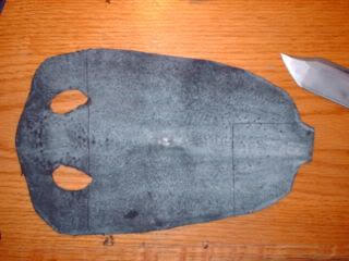

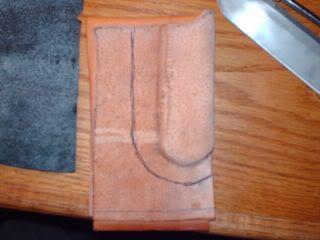

Drawing out the patern on the ray skin.
Pattern drawn out.

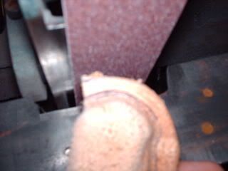

out to the grinder to equal up the edges at the fold.

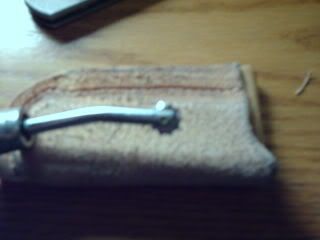

My homemade grooving tool
putting a groove down the leather

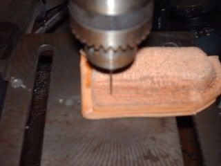

with the leather grooved i now mark where i will drill the holes with this little tool.
roughing up the leather on the inside of the sheath before gluing.
Didnt get a shot of gluing the sheath. this is a posed pic cuz i needed both hands on the drill press.belt loop was out of the way when i drilled;)

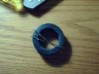

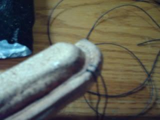

i use the "cross stitch?".

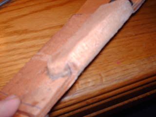

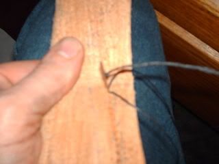

taking the needle through the first hole I even up the thread and then start passing both needles through the next hole from opposite sides.
this continues down the sheath til i get to where i will be attaching the belt loop.

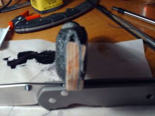

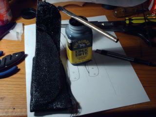

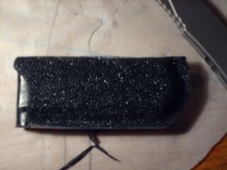

now its time to add the ray skin.

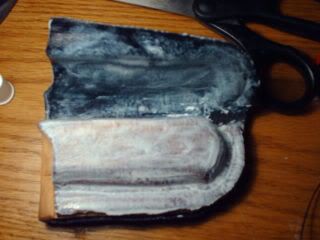

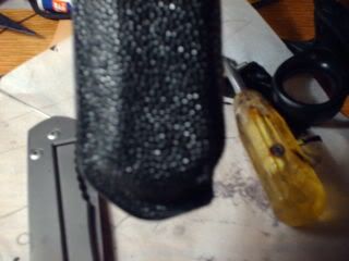

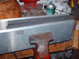

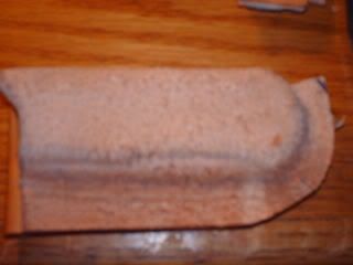

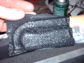

U can wet rayskin to make very pliable but you cant form it do to its thinness. so i positioned it where i wanted it on the sheath and smashed it together in my kydex press and let it dry overnite.
end result of putting it in the press

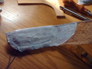

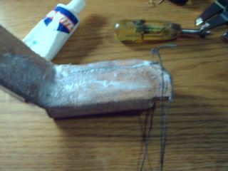

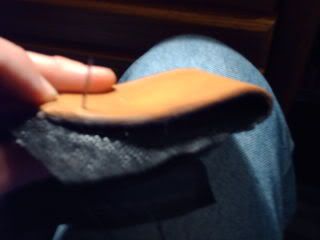

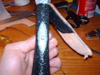

remove the rayskin and spread an even layer of glue on the back side of the sheath.
make sure you run the thread and needle thats on the back side of the sheath through one more hole to bring it back to the front.
otherwise you wont be able to sew the belt loop to the sheath because the thread will be glued under the rayskin.

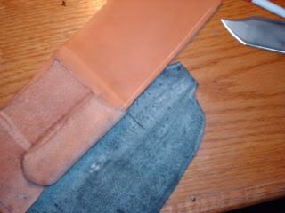

i didnt take pics of drilling through the rayskin and the belt loop. but after the glue has dried it was back to the drill and i floded down the belt loop and followed the holes that were allready on the sheath and followed through with them through the belt loop.
Before i stitched the belt loop on i took some edge coat and painted the underside of the loop.

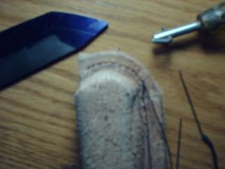

now i start stiching the loop to the sheath

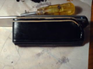

i trim and sand down the ray skin around the throat of the sheath
now back out to the grinder and sand to final shape.
added the decorative grove the rest of the way around the belt loop then painted it with the edge coat.

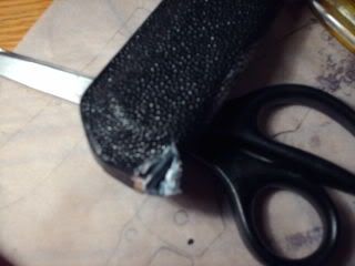

now to take care of this problem.
cutting a slit through the ray skin twords the top edge of the sheath i then spread some more glue in the opening and trimmed the excess off then pressed it all down again and let it dry.

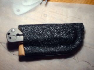

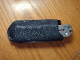

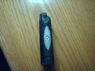

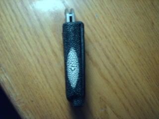

after that i sanded down the edges of the ray skin then gave the exposed leather a once over with another application of edge coat. and heres the finished product.
It was a fun project and now i have a beautiful sheath to carry my benz in.:cool: Thanks guys for the support to get a wip goin on this and thanks to DC for the ray skin info.
And last but certainly not least is Mr.Graley. Thank you for sharing with us how you make your sheaths. without your knowledge and methods i wouldnt have made this sheath. so THANK YOU!!:thumbup:
