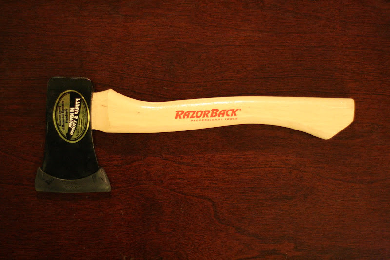

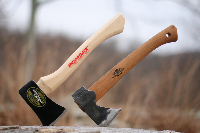

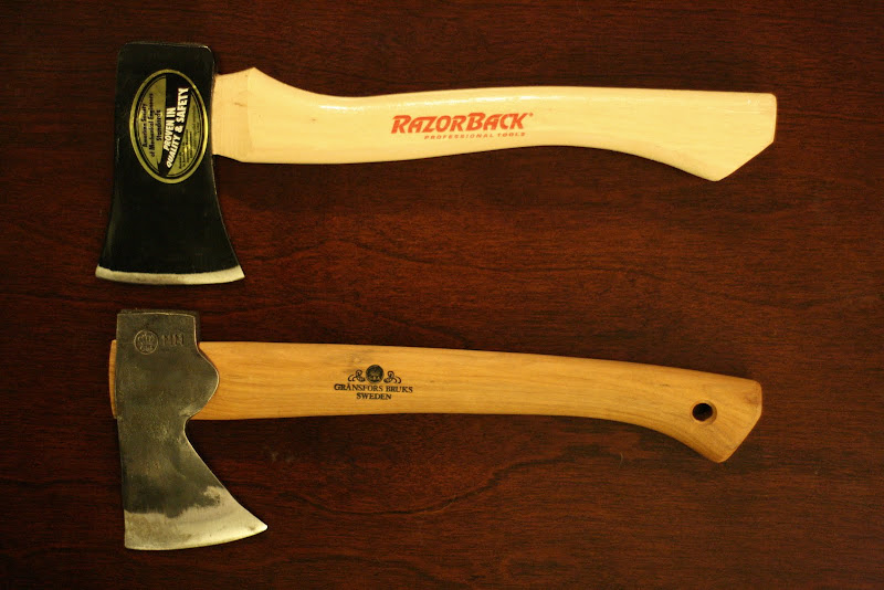

As with all the other hatchets, I will compare this one to the Gransfors Bruks Wildlife Hatchet. Here you can see the Razor-Back Camp Axe next to the Gransfors Bruks Wildlife Hatchet.

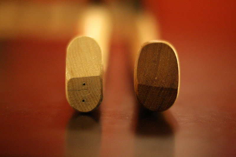

The handle is the same length as the Wildlife Hatchet, around 14 inches. The one I bought had good grain and seemed to be of good quality even though it was covered by a very thick coat of polish.

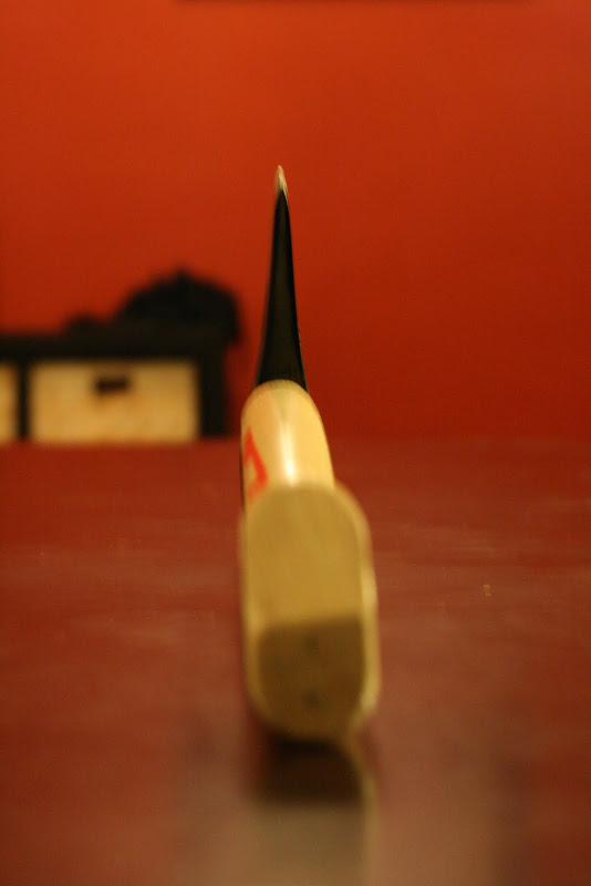

The head was not properly aligned with the head on the example I have. As you can see, the head stands a bit to the left of the handle. This is an unfortunate reality when it comes to low cost axes.

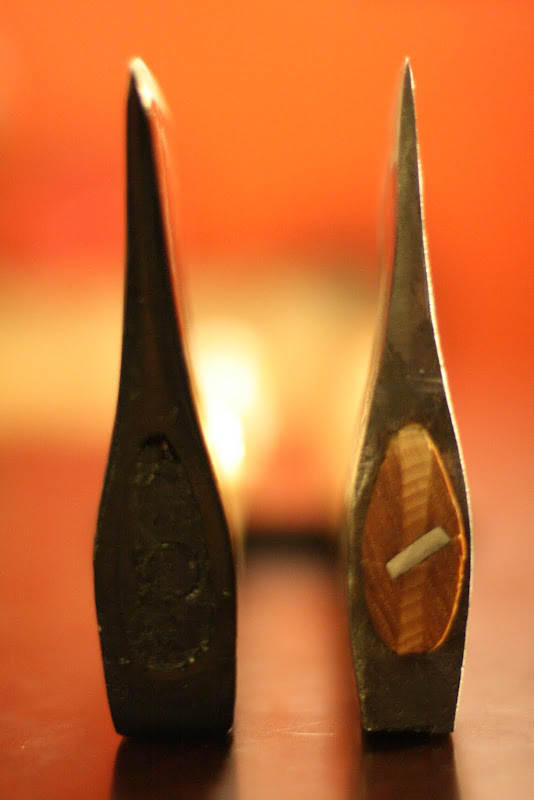

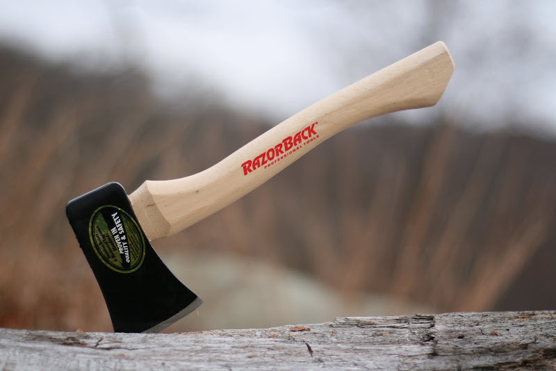

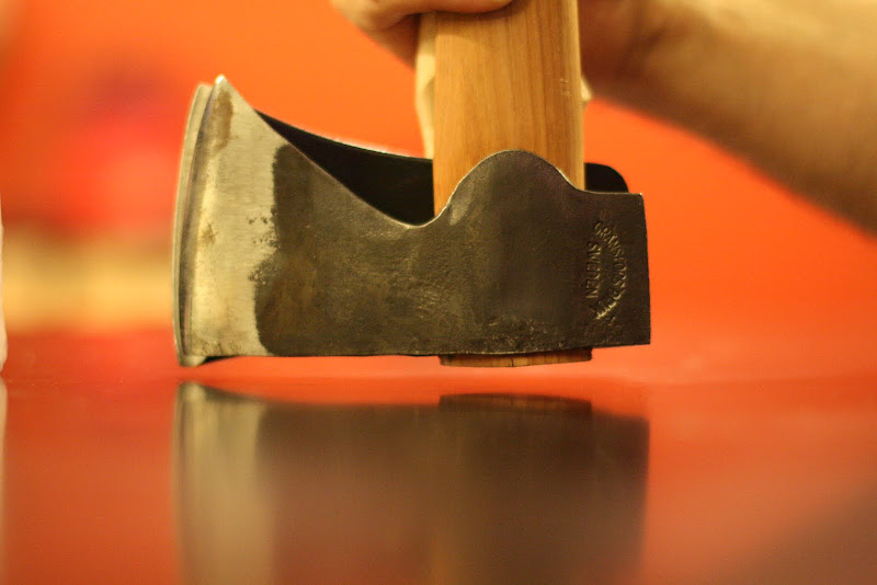

The head itself is very poorly designed in my opinion. It has a very thick cutting edge, which significantly decreases its chopping ability. In fact, it was so thick that I had trouble getting it to stick in the oak for the pictures. The head then continues to be fairly narrow, until it reaches the eye. At that point it expands significantly, creating a huge eye. I dont see any reason for such a design, and it significantly hinders the chopping ability of the hatchet.
Splitting is not too bad. While some force is required to push the large eye through the wood, the fact that it is so wide, and the edge is so thick, splits most wood quite well. The head is attached to the handle using a wooden wedge and a circular metal pin. The top of the handle seemed to have been damaged and splintered at some point, but the head did not become loose during testing.

Overall, I can not think of any reason why anyone would spend $30, $15 or even $10 for this hatchet. It gets significantly out performed by the Gransfors Bruks Wildlife Hatchet, which is a quarter of a pound lighter than the Razor-Back Camp Axe. There are many other much better low cost options out there on the market.
