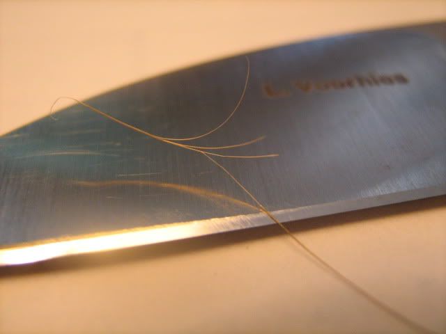

The aligner is the only "system" I have ever used, I found it to be very easy to use and produce very sharp edges. When I don't feel like free handing or if I need precision its my tool of choice, I use it with my DMT benchstones because I don't have the XXF for the aligner but either way your results will be like this. This is after the XXF, no stropping.
