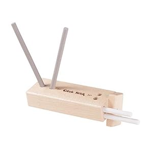

I use this:
Lansky and a strop. Moosez Becker stay scary sharp.
