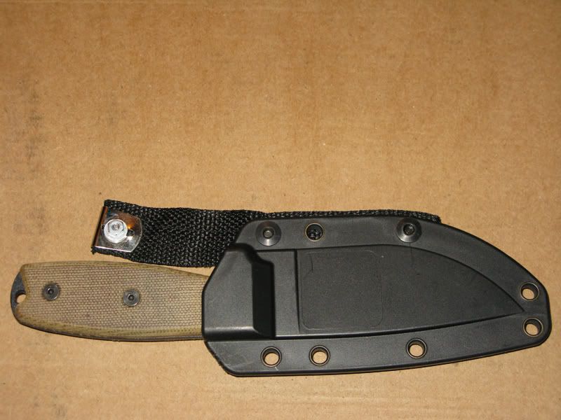

Okay, first of all, yes, that's an Ontario RAT-3 in these pictures, but the sheath modification should be pretty much the same. As I understand it the RAT-3 and the RC-3/ESEE-3 are practically the same, except the ESEE has a 3/8" longer handle. Anyway...
I was looking for a good way to carry the knife in my pocket without it sliding around.
All I did was take a piece of 1" nylon strap, the pocket clip from a $1 measuring tape, the chicago screws that came with the knife, and one addition nut and bolt to rig this together.

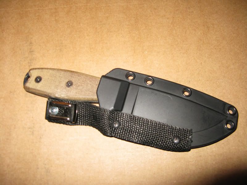

Here's the other side.

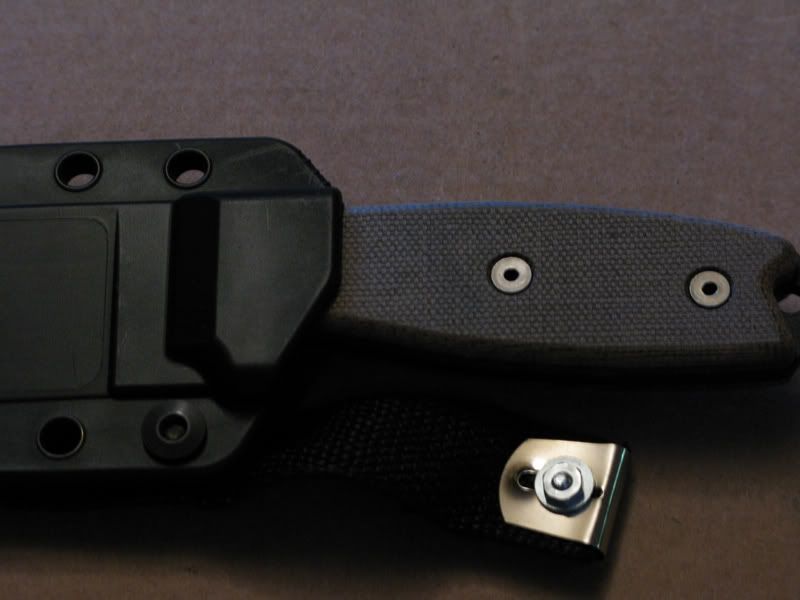

Better shot of the little nut and bolt that fasten the pocket clip to the strap.
