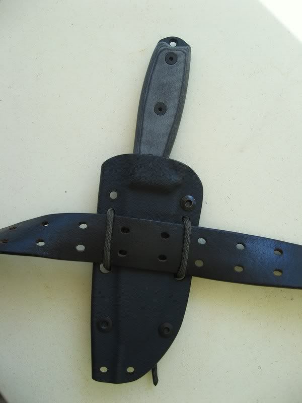

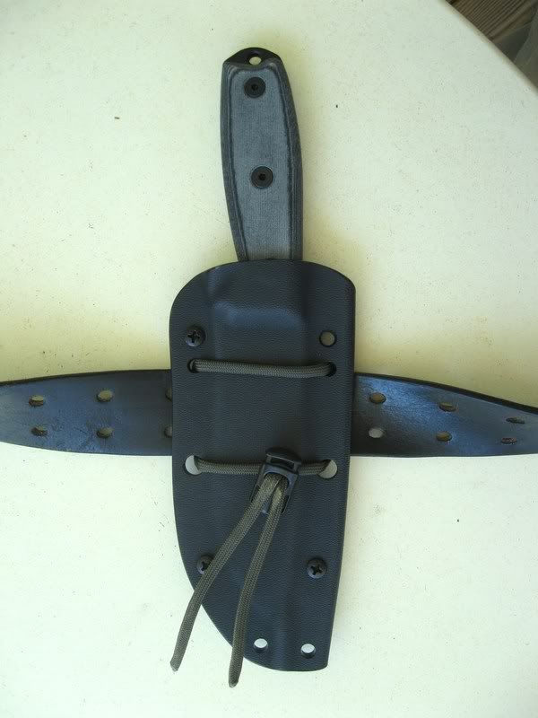

Being a simple person, I like method 4. I hate MOLLE locks and overly complicated and bulky sheaths, but I can see their use for military personnel.
I think this is right. It works.
I probably will lash it straight to my outdoor gear bag, as I rarely carry fixed blades on me, except for neck knives.

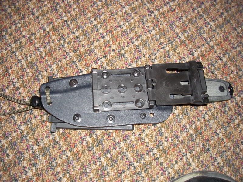

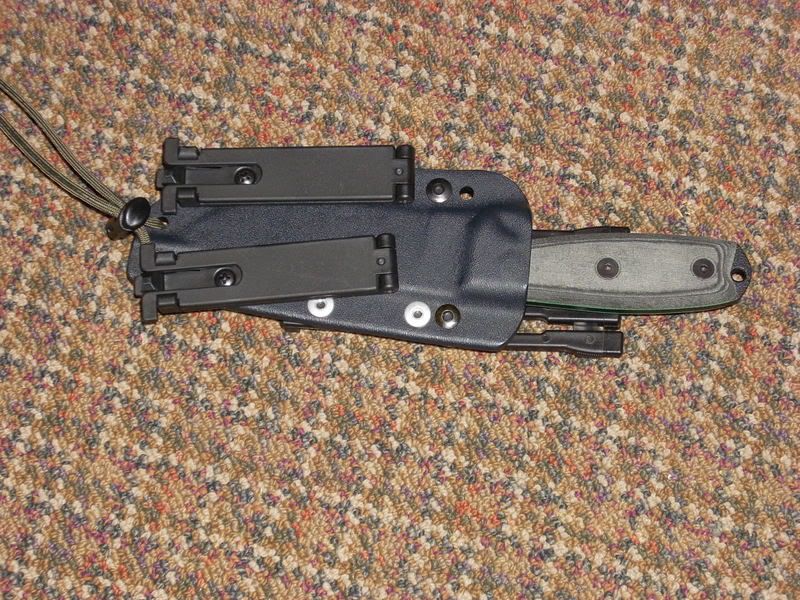

A Tek Lok can be mounted pretty easily by reversing the screw and barrel from the way you might usually install your Tek Lok. Place your screws on the inside of the Tek Lok itself, and run the barrels in from the outside of the sheath, on the middle two holes (spine side works best). I've got mine set up w/ a Tek Lok on one side and Molle Loks on the other - which makes it easy to have your rig attached to a pack, and then move it directly to your belt if your downgrade your pack without having to change attachments.
I used the silver barrels that are supplied w/ the Tek Loks, but the black barrels supplied w/ the sheath should work just fine. I have one of my Molle loks attached with 2 screws, the other with 1. With plenty of screw holes and several attachment options, this one of the most versatile sheaths I've ever used.
