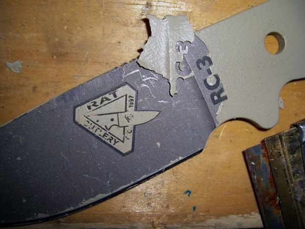

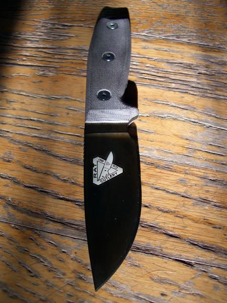

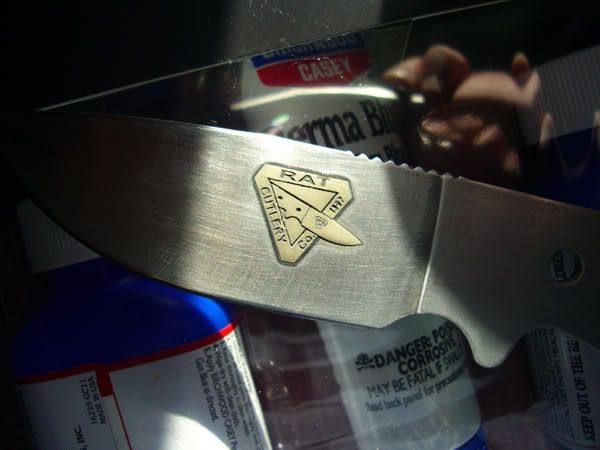

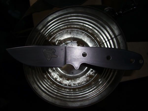

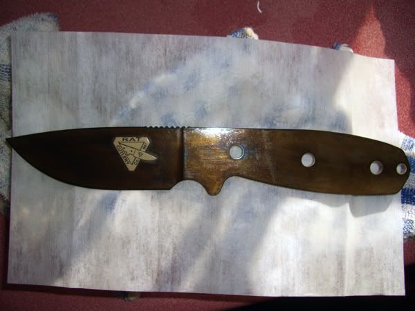

I just finished taking the original black coating off of my new RC-5; useing Klean Coat stripper. Sprayed it on, wrapped it in Saran wrap and 45 minutes later, the black paint literally fell off...very easy job. Under that black coating however was not bare metal, but rather a gray colored blade. I sprayed again with Klean Coat, but still it looks as though it has a kind of satin grey finish? I like it, no complaints there, but so much for vinegar and mustard patina process; I wish I could attach photos to show you this blade, and will ty to do that. Was wondering if anyone else had experienced this, or could shed some light what's going on.

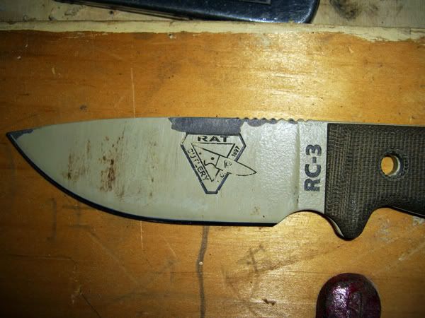

Then I hit it with gun blue.
Of course now it looks like this:D :

Well, as you can see in the first pic, I had wailed on it pretty hard up to that point! I figured I owed it a little touch-up. ;) It isn't the most durable coating, but it only takes about 15 minutes to reapply when it gets really bad. I just haven't bothered since I like the rustic brown-black patina that it developed through the scratches in the blueing. If there's one thing for sure, it's that my RC-3 has a hell of a lot of character now! :p
