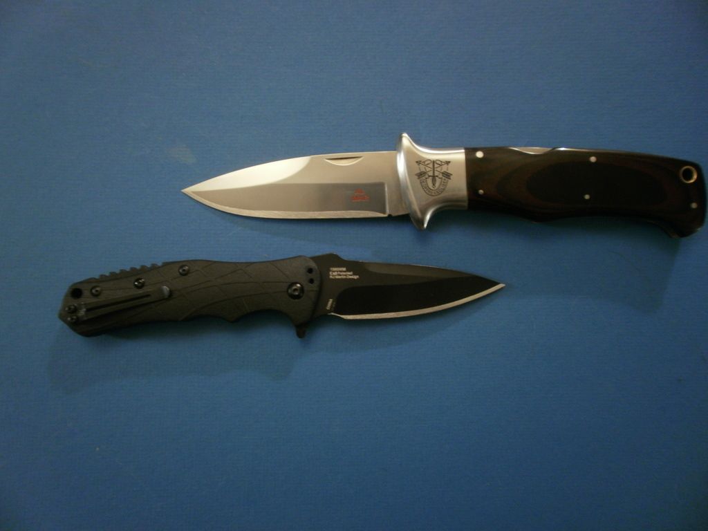

The whole issue of taking down the angle depends on whether or not the blade has a hollow grind or not.
If the surface above the edge is hollow ground, it will go down to 12 per side, as on mine below, with no problem.
If it is flat ground, as on the Al Mar above it, then you are in for a world of hurt keeping the knife looking good (as I obviously failed to do free hand): My AL Mar has been sent for re-finishing by a pro, probably to a zero edge or something useable...
Re-profiling on a hollow grind is like day and night compared to any flat or convex grind... That is the main issue when re-profiling.

Kershaw edges are horrible. 28 degrees on a folder doesn't surprise me from them...

As the edge grind gets wider its going to show every unevenness in the primary - really for the amount removed it looks pretty good. At some point it just winds up being easier/nicer to regrind the primary but also a real bear to do freehand.
Edit to add: this is also where where a full or high grind convex comes in handy...:D
