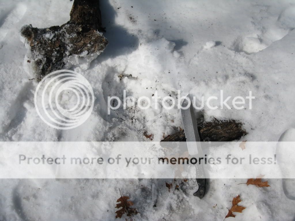

I personally would just strip the entire blade. Rust is not too much of an issue as long as you dry off the blade if it gets wet. I stripped my FBM and used it most of the winter in the forest... I had no issues with rust. Plus it looks a lot cooler when there is none of that nasty coationg covering up the raw infi ..
+1 on the stripper... I stripped my SAR5 (below) because I really prefer a non-coated blade. It is not necessary to remove the micarta handles when stripping, I was going to polish it up but decided against it.
If you want to keep it crinkle then look in an auto store that has a healthy selection of engine/valve cover paint. There is a black crinkle coat paint that looks very similar to the busse coat. It's very durable as far as air drying paints go but takes a few weeks to cure to full hardness at room temperature. I'd just strip it, or not worry about it. Rust is not an issue on infi, while on the coated models there's often a layer of rustable decarb (paper thin) the infi beneath is pretty rustproof. Any rust you see is just cosmetic and will come off with a little scrubbing. The decarb soaks up oil well, if you keep it oiled even the decarb won't have problems. I've tryed making it rust faster in hopes of getting the decarb off easier, it's worked but still alot of elbow grease to get into the corrugations.

Here is my FFBM all wet and no rust after this day in the woods..
