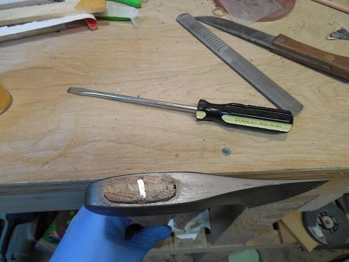

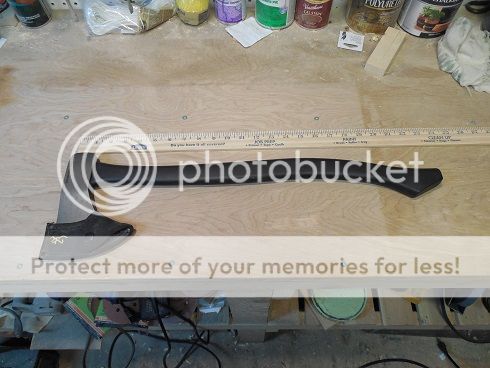

Silverthorns earlier thread on the Browning "Outdoorsman" axe led me to try and see if I could remove the bendy plastic handle on the Browning I picked up a few years ago and replace it with a hickory one. Not something I've ever done before but what the hell, it was gathering dust in the corner of the shed and I felt like tinkering tonight. Here's the photo journey for anyone else who has the same inclination.
Bendy plastic handle.

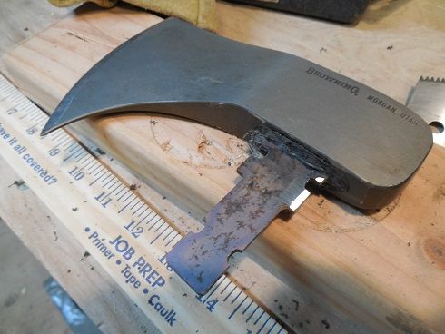

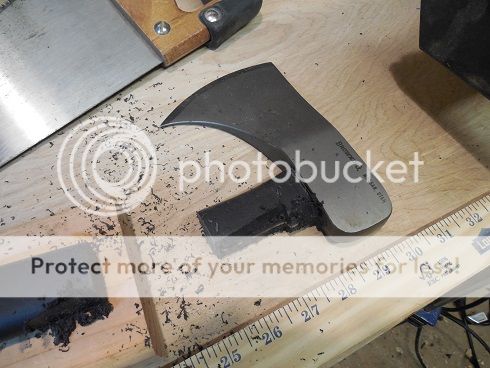

Handsaw and grinder to find the metal I suspected was hiding in the neck.
Here's what's hiding in the neck

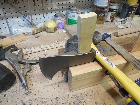

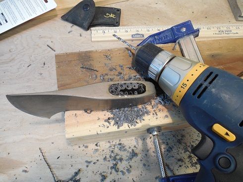

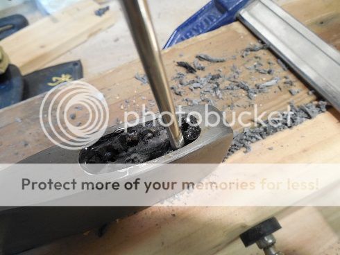

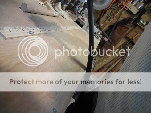

Drilled it out and found that the plastic was not actually bonded to the metal and I could peel it back with a screwdriver. Improvised lug pounded out what was left.

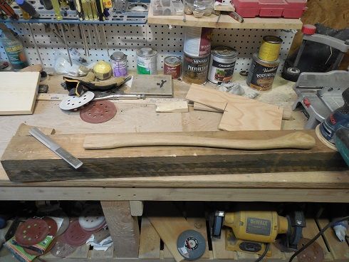

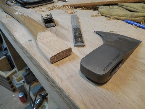

Handle from the local hardware store, gotta cut it down.
Now to work with the rasp, sander, and my personal favorite for shaping wood; the pocket plane.
It fits.

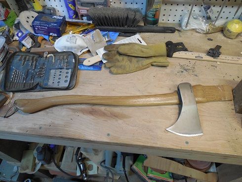

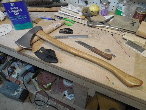

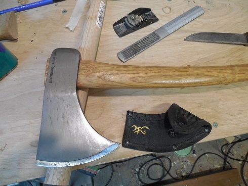

A bit of epoxy after I roughed up the neck with the rasp a bit and the heads on. Damn, cut the wedge to short.
Sanded off the varnish and rubbed on the BLO.

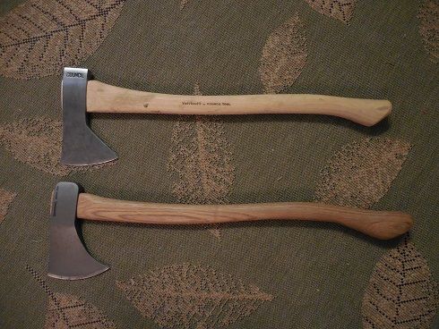

Just for comparison, here's my swapped out handle axe next to one hung by someone who knows what the hell they're doing.
Now I'll have to head out and see if that tiny little eye will hold onto the handle.
Very nice retrofit and very nice pictorial 'walk through'. You've obviously done customs and re-hafting before. I suspect 'she'll' no longer be sitting in the corner now that there's a real handle in place. Let this be a caution for future purchasers of plastics.
Nice job on a nonstandard eye.
You know your way around your work bench. :thumbup:
Thanks folks.I'm still a little worried about how small the eye is. We had a bunch of limbs blow down over the last few days. When I get some free daylight hours I'll go see if it holds together under strain.
