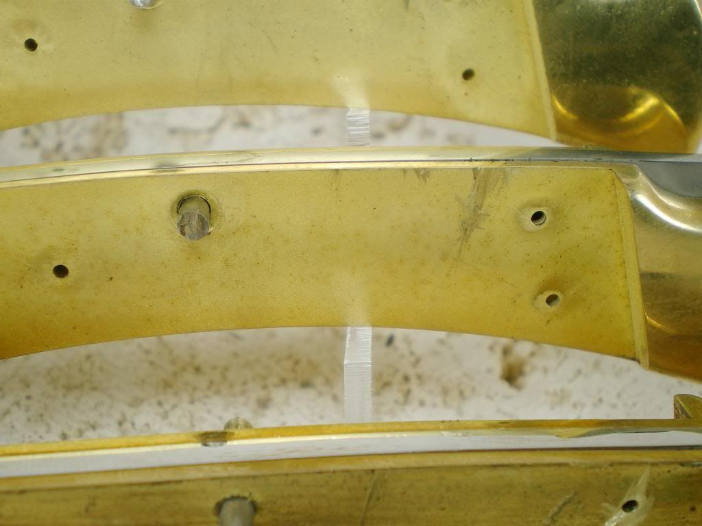

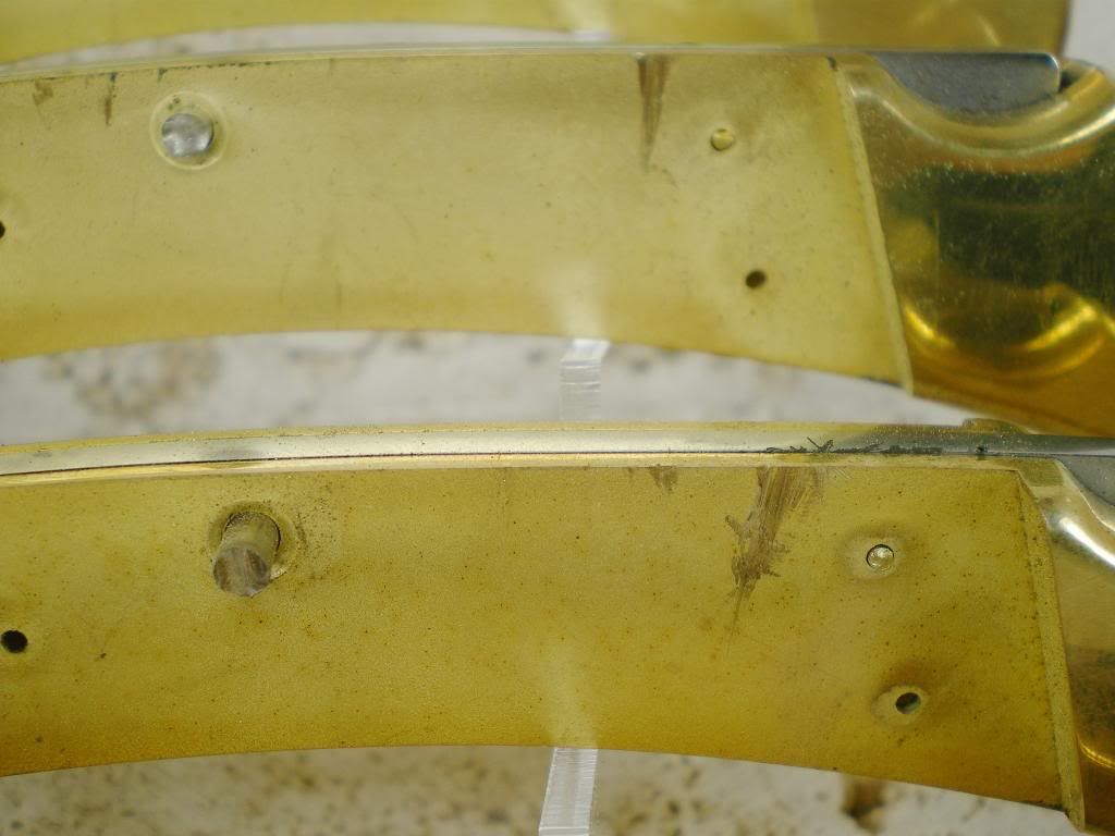

I guess I didn't have to remove it, but the rocker rivet needs to be cut off and peened flat to the liner on each side.
I was just playing. :)

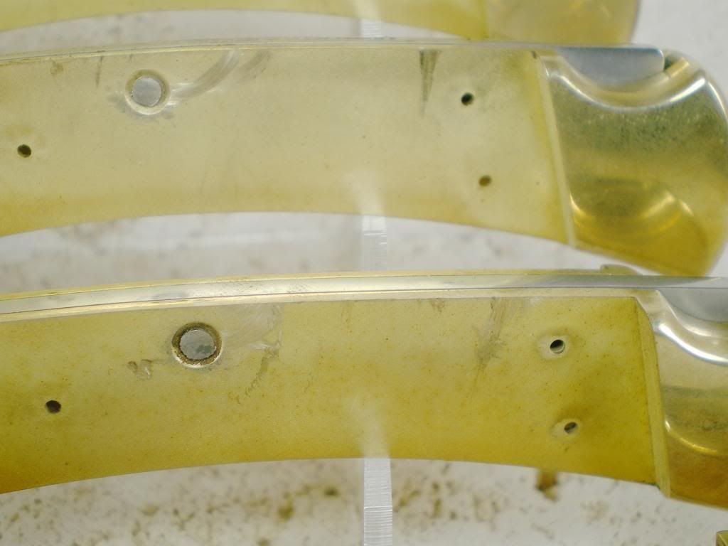

Also, make sure you get the leftover scale rivet pieces out of there. The ones behind the lockbar spring.

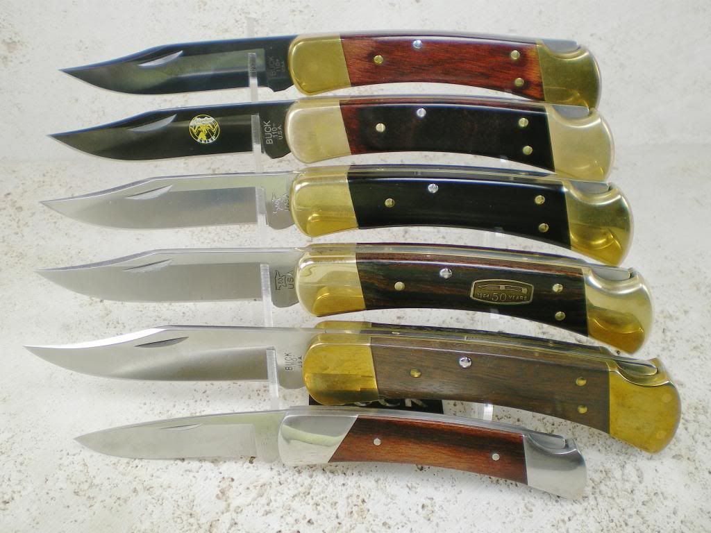

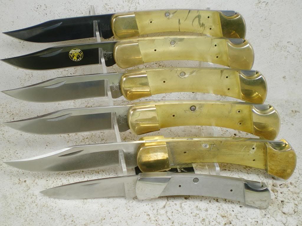

I Just took the scales off a few Buck 110's I'm planning on dressing up with Sambar stag. I told you wrong earlier about not having to take the rocker rivet, arm and the spring out of the frame.
I had to take all that stuff apart to get the top rear pins out on these five 110's. The pins sit right against the spring and wouldn't come out. They would catch on the spring a little sometimes and the action wasn't smooth like it should be.
It's easy enough to take apart to get those last scale pins out though. I am getting much better at putting them back together again too. :)
