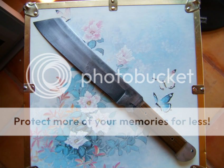

Here's a profile of the blade and handle:

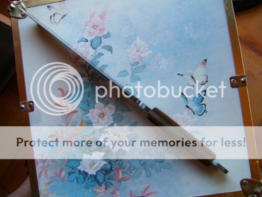

Next I laid the knife on its spine and took a shot looking down on the bottom of the blade and handle:

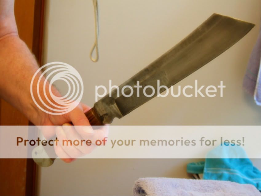

Had to use the bathroom mirror to get an in-hand shot:

Looks great. Now admit it, you took that big knife into the washroom to admire it while otherwise occupied didn't you? The whole mirror thing was just a rationale :D :D

Also, from the pics it looks like the tubes are not flared too much.

Yes, United Cutlery, so it was not expensive. The looks have been improved beyond adding the wood handle. The blade on the original was coated with some sort of black goo, and that was removed. The steel beneath was fairly irregular and, by agreement, was not modified in the blade. The tang area was polished flat to permit mounting of the handle scales. Also, the original had a spike just in front of the handle; the spike was rounded off such that a small choil was left just behind the base of the blade. The project greatly improved the profile over what it was when it arrived from United.
Tubes not flared? Not sure what you mean.

From the top picture it looks like the slabs are attached with hollow tubes and hollow tubes are flared to lock the slabs tight with the tang but in your picture the flaring looks very small. Obviously insufficient flaring could lead to the handle slabs coming of after enough chopping. maybe it's just the pic or my eyes.

Well, they're certainly not flared to the extent you see on a Busse, but they resemble what I see on some other knives such as the SBT and some BRKTs. But I agree, more is better. I also would have preferred to see 3 tubes instead of 2. But, if you know the story of this transaction, I'm surprized to ever get to see the RIV again at all. The project took 13 months and there was no communication for the last 6.
