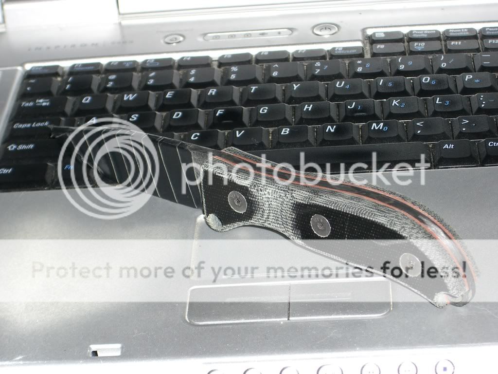

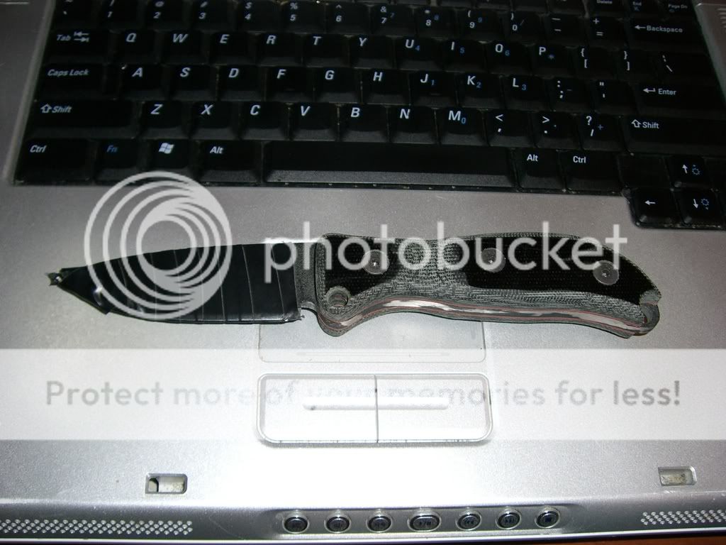

Anyway, here's an update
Used the jig saw, didnt have clamps so I just held it down with my palm. Did most of the sanding with the dremmel. Still got a ways to go custom fitting the handle ergonomics.
This ones going to get stripped and hopefully mirror finished eventually.
I sanded the slabs till they were mostly flush, but I had to remove them to sand the ends, and I'm having trouble getting the slabs lined up perfectly when I reattach them. Any suggestions?
To get the slabs to match perfectly would require one last sanding as a final step after all of the screws are locked down tight ensuring that the handles will stay put. That would probably be the easiest way. You can also try fitting the handles perfectly with some superglue (assuming that they were already sized correctly) before attaching the fasteners.
Sounds like a plan. I'm guessing I'm going to have to re countersink the screw holes with a drill press, I did them manually with the dremmel so tightening the screws will probably push it out of alignment.
The countersink looks fine to me. Like I said. Tighten down everything first followed by another final sanding to flush everything up.
