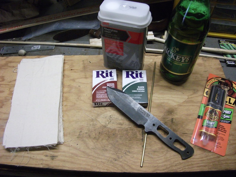

So I started my re-handling project, already ive modded the bk10 to be more of a bushcraft style knife, now on to the micarta handle.
If you want to read some good advice on making your own micarta handles for your becker check out this thread http://www.bladeforums.com/forums/showthread.php/944340-Home-made-micarta

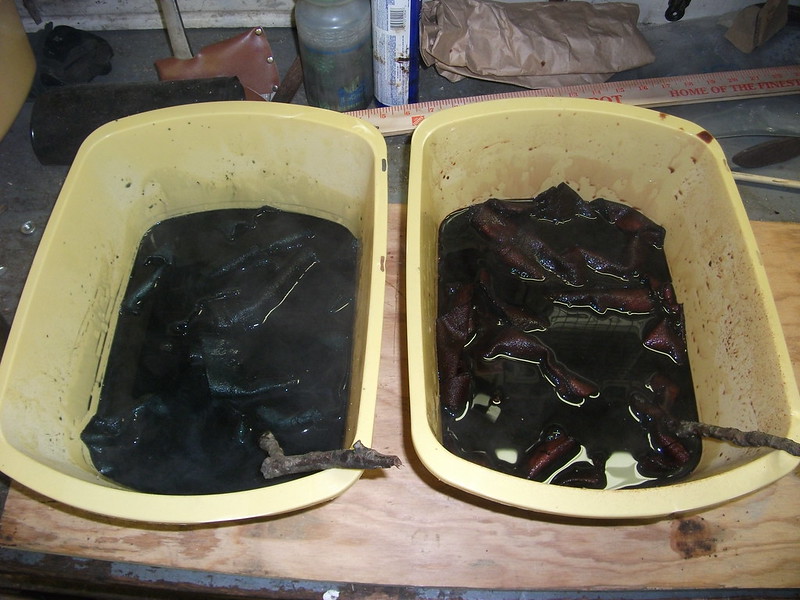

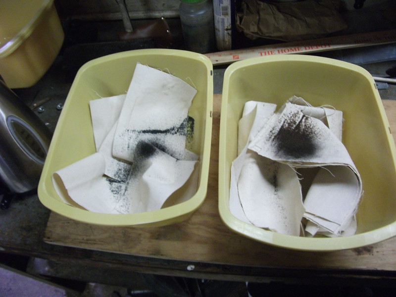

Step one was to gather everything I needed and dye the fabric I'm going to use to make the micarta.
I'm going for dark green as a liner next to the knife and brown for the bulk of it.
Next I just need to wash out and dry the fabric.
