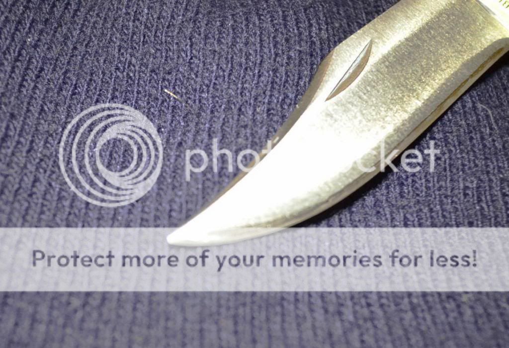

Is it possible for me to be able to repoint the tip on this early 70's 110 with say a Lansky system (non diamond)? When looking at the knife from a normal distance by eye you can not really tell the very end of the tip is blunted but when looking closer I noticed it. I would say its about 1mm flat at the tip.
I was wondering if I kept sharping the tip from the blade end up towards the spine would it eventually be pointy? its totally functional, more of my OCD that is the issue.
I would not be comfortable working from the spine end down to the blade edge nor do I have the tools to even do that.
http://i803.photobucket.com/albums/...2-6e09-42c8-9a45-111d7e07e206_zps22f96080.jpg
There is your picture. To post a a picture, you click on the "get link codes" on the top left of the page and go to the bottom "IMG" option.
Anyway, i think you would have no trouble on the Lansky. If you have the red coarse stone it should be easy to sharpen it down to a tip. I have done this to a few knives.

Brother broke the tip off this 470. Didn't take long to reprofile it with a Lansky.
Could have trimmed the belly down a little more, but kind of like it as I left it.
wow, that is impressive.. I will have no trouble at all then with the tiny tip that is missing from mine. thanks for the photos, great job on that tip.
I've had to rework a few tips. One thing to keep in mind, if you can, grind down the spine to edge instead of grinding the edge up to the spine. If you remove extra steel from the edge side your knifes point may stick out when the knife is closed. :)
