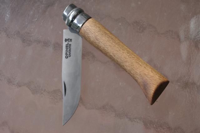

Opinel by Pinnah, on Flickr
I'd suggest finishing it with a couple coats of polyurethane. It will give it a nice smooth texture, and will protect the wood from water and stains etc. I have oiled a couple of handles in the last, but you have to maintain them and re-oil frequently.
I now prefer to not disassemble. When you take them apart you have to sand the peening off one end of the pivot pin. That peening is done just so (usually:rolleyes:) at the factory to fit the groove in the locking ring well. Every time I've disassembled the locking ring has then "ridden up" when I locked the knife closed.
Of course you can do a better job sealing the wood inside and out if you take it apart and it's easier to sand, etc.
Anymore though, I just take off the locking ring, tape right up close to the wood and go. When I'm done sanding I'll *dip* in stain, which usually has some linseed oil and will seal the inside a bit. A few coats of tung oil and then a mineral oil soak.

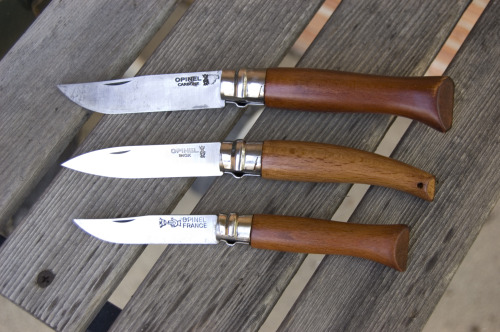

Here are three Opinels (#9 carbon, #8 Garden in stainless, #6 carbon) done at the same time in the same batch of dye (Rit Warm Brown) a couple months ago. After the excess stain was washed off in cold water and the handles were dry, I applied General Finishes' Arm-R-Seal (oil & urethane topcoat) in satin. Five coats wiped on with a rag.
As best I can tell, I sanded and dyed them all equally, but I've had the #6 since the mid-1990s and it saw use off and on since then. The #9 was also used and handled a fair bit between buying it last summer and the refinishing project.
Clearly you can see differences in tone among them. What I take away from this is that if a piece of wood gets handled significantly, it will probably absorb oils and dirt from your hands. This accumulation needs to be sanded away if you want an even coloring, but it may not be possible if the contamination has really sunk into the wood. Second, I assume that while all handles are beechwood, the wood's grain and probably porosity varied according to the piece of wood used, how it was seasoned, and where it came from in the tree. These factors will obviously affect the stain's depth and color.
In the end, I don't care about the variations. I'm a knife owner, not a manufacturer looking to produce a perfect and unvarying product. And in any case, an Opi simply invites user modifications, both to the handle and the blade.

The dye is cheap and easy to use — watch those splashes! — but from comments by others, be sure to sand the handle thoroughly. Beechwood apparently varies somewhat in its ability to take on dye.
I'm thinking of reshaping the #9's handle, but the other two are fine. Good advice about the upper knob. Thanks.

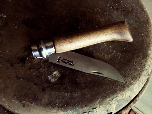

Agreed. Sand thoroughly! Spots that you have sanded harder will absorb the dye faster and in a larger quantity, resulting in a darker shade. This might result in different shades of darkness as in this example of mine, where the butt of the handle was sanded a lot more than the rest. If you've bought a carbon blade, the handle is already treated and that might be inside the wood quite deep.
[/QUOTE]
Nice chrysanthemum (?) emblem on the Opi handle. Gives the (French) knife a vaguely Japanese look.
