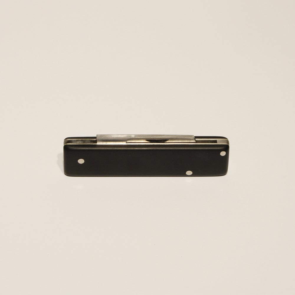

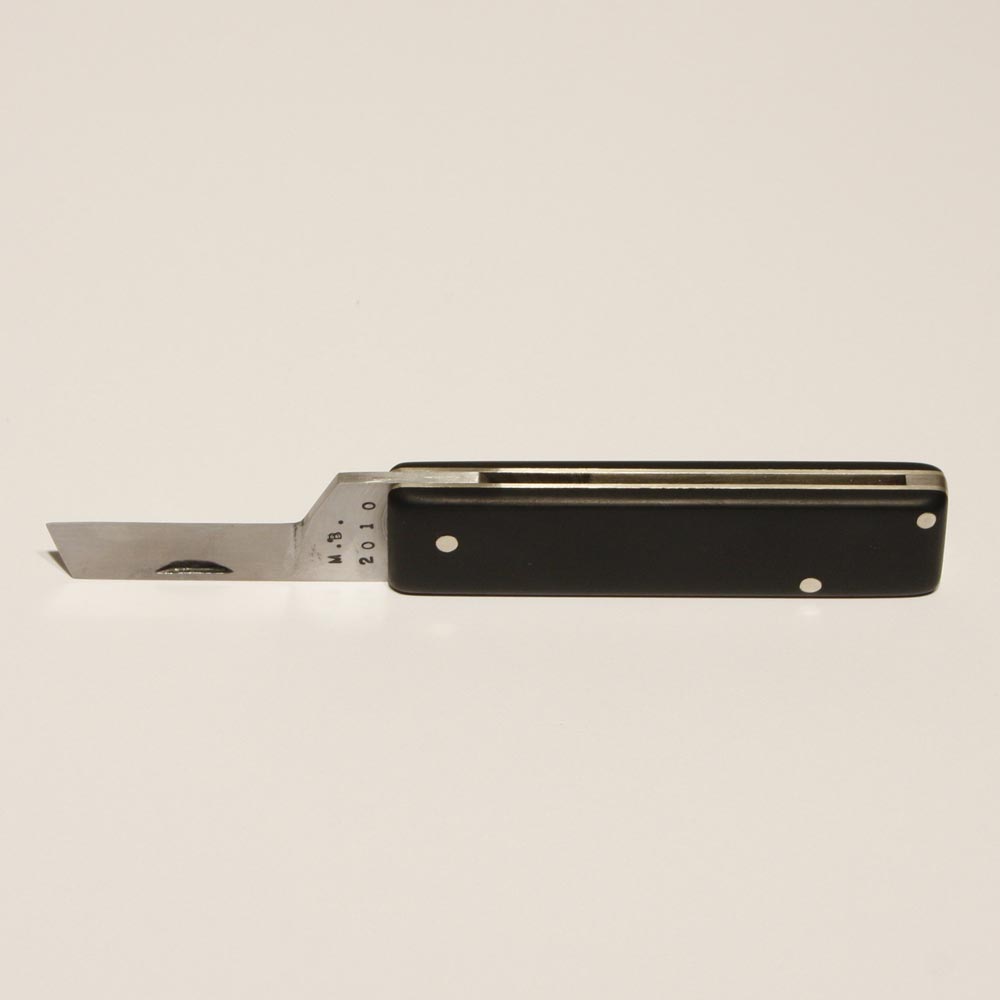

And I've made a knife! I drew up my own design in Google Sketchup, which I really like. The blade and spring are 3/32 precision ground O-1, the liners are 1/16 nickel silver, 3/32 nickel silver pins, black paper Micarta scales. I cut the nail nick by hand with the Foredom.
I like the design pretty well, though it's much simpler than most of what's posted on this site. I'm making small slipjoints for whittling, and after using the 3/32 O-1, I realized 1/16 might be better suited for me. Should I sill use 3/32 pins, or can I use 1/16?
Below are the pics. Any advice/comments are greatly appreciated.
I concur! Great lookin lil guy... albeit a bit cubist for my tastes... LOL! (artist joke... :thumbdn::rolleyes::foot::p booooo bad joke...) yea I just heckled my own joke! seriously though, Nice lookin lil slippy!
Jason
Thanks guys. I'm definitely into designing more geometric knives right now. I think that appeals to some people, but for most it's a little jarring looking. I plan on starting on one today that even has a square tip... I imagine it being a nice picnic knife or something.
Any additional comments are appreciated. I can't begin to describe how much the content on both this forum and the Knife Network have been in speeding up the learning curve for me. So thanks again to all of you.
