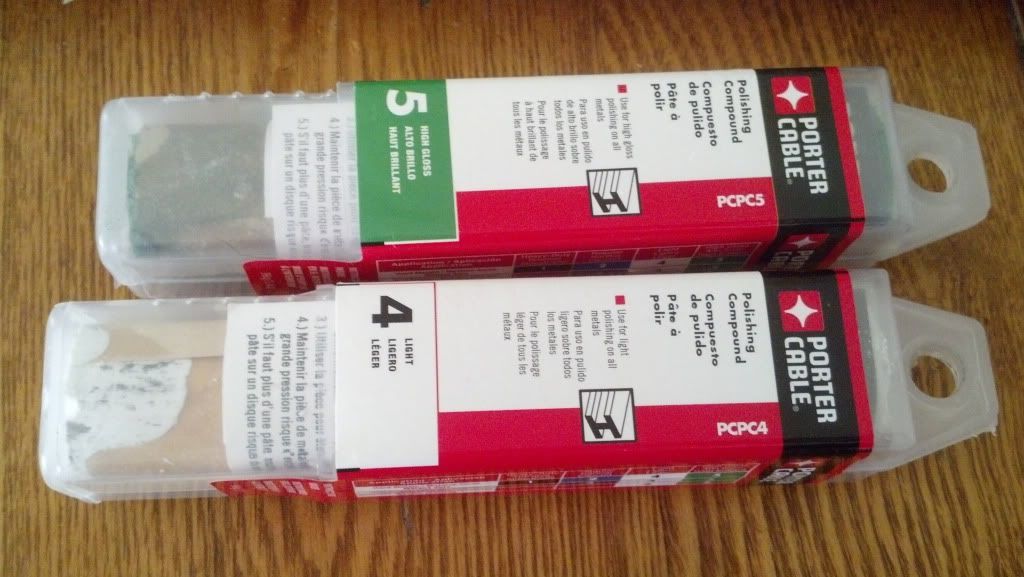

Looks for these at Lowes. They work perfect. I use 1,4 and 5. As does Mothers.
