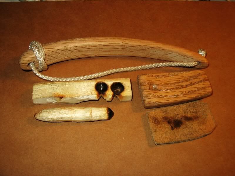

This below is basswood (and a very small set):
Great wood for bowdrill. This set worked very well considering its size, several ambers, four fires from it outside in the dead of winter.

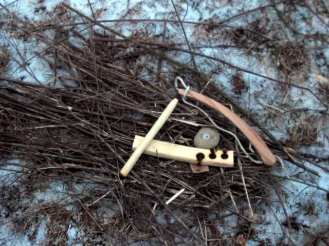

And here's its bigger brother (not very big though :) ):

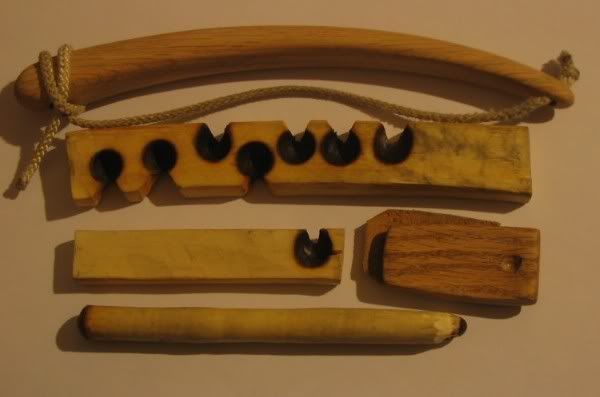

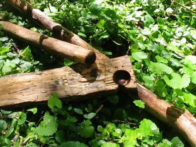

The one below is a mystery wood, after some experience you can usually tell how adequate a piece of wood is when you pick it up:
It worked on the first try. Good luck with your attempts! :thumbup: :D

That is a bit of a small kit. Were you involved in the contest for smallest working set that was going on a little while ago? I saw some mention of it in the Bulletin of Primitive Technology and also heard about it from David Arama.
Excellent job, by the way! :thumbup:
And were you cooking up that Garlic Mustard? :)

There was a contest? Damn... wish I'd rather not have missed that, sounds like it would have been fun. :)
WabaJack, that drill set look remarkably like the one in the wikkipedia bushcraft definition, HMMM...
Yep, that would be mine, lol. Both of the pics on that page are mine actually. :D
