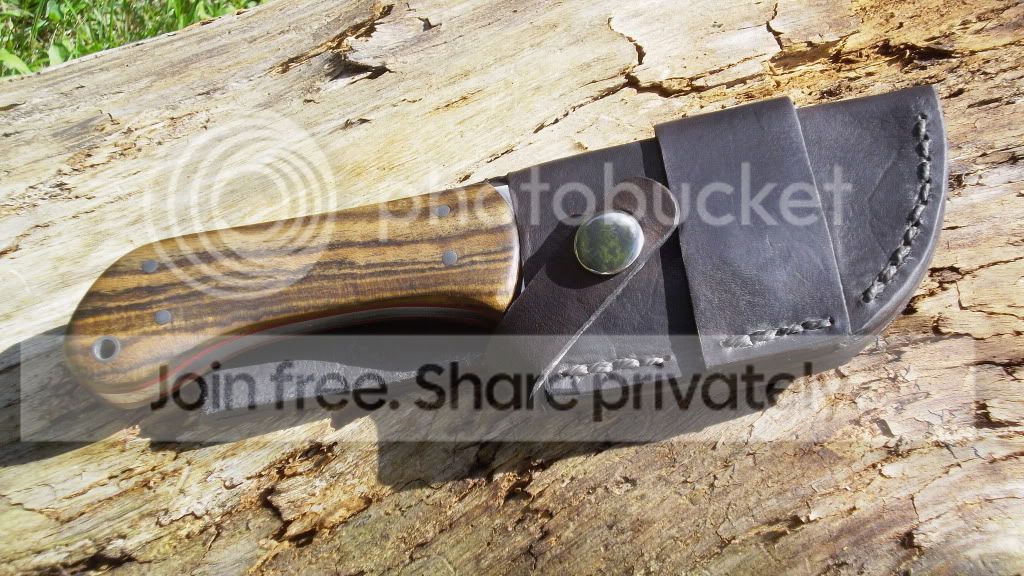

Hey guys,
I've been messing around with knife making and leather work for about a year now (I'm 24 y.o now)
I recently finished a blade that I personally feel would be something that is "marketable". I've also received positive input from friends and family, which includes a lot of hunters. (Although I do take it all with a grain of salt because I doubt they would say anything negative)
What I was hoping for from you guys is an honest knife makers opinion as to whether or not what I have looks like something that would sell.
Some specs are:
- 1095 blade steel. Forge heated and oil quenched. Tempered at 450 for 1.5 hours.
- Flat Ground, Hand finished to 800 grit
- Bocote Handle Scales. Red .030 vulcanized paper liners.
- SS 1/8 pins and SS lanyard liner.
- Dyed Leather wet formed sheath.
- OAL: 7.5 inches Handle: 4 inches Blade: 3.5 inches
Thanks in advance for the input guys
BOTTOM BLADE
Your work looks as good or better than some of the pieces you see listed here in the classifieds. I think you would be justified in putting them up for sale if you are comfortable with that. It is worth some thought, though, about what market you are going to try to start selling in and when. Entering a competitive market as an unknown maker may cause you to under-price your work and set a precedent, and you might have to (or feel that you have to) justify a price increase to your customers at a later date. There is also the perspective that once you put a piece in circulation as a professional, especially with your name on it, it speaks for you from that point onward, so the quality needs to satisfy not just your customer, but yourself, as a professional.
I don't want to discourage you, I think your work looks great and I think it would sell on this forum if you were to list it at a competitive price. Whether you are ready to take that step is up to you, but either way I don't doubt I will see your work somewhere before too long.
the only think I would suggest is that you would work on sharp grind lines. they are really kind of dull, and a sharp grind line will really make some knives pop. this is coming from the guy who intentionally dulled his becuase the grinds were SOOOO uneven, but i think it looks really nice.
Two things:
1. Throw the vulcanized paper away and never buy or use it again. It only looks good until you get the knife sold then it moves on you. Switch to the stuf from alpha. It is micarta, if I recall.
2. Get a maker's mark if you are going to let your knife leave your hands. It makes them look much more professional and is worth the money.

Definitely good enough to sell. Now the hard part is what to ask for them.
I agree with above about the mark, and the vulcanized fiber.
+1 on the vulcanized fiber spacer, use thin G10 from AKS or Masecraft. I have never used vulcanized so can't speak from experience but have seen it cause problems for enough makers that I wouldn't touch it.
Will it sell?
Everything will sell, it depends on price & only has to appeal to one person.
It surprises me what will sell.
Things I would want to change.
In your sheath - use a stitch groover to groove out a line to keep stitches below the top of the sheath.
The Wild Rose and Paul Long videos are excellent.
I like the smaller top knife, not the bottom one.
The handles are more or less identical, so the differences are inthe blade width, bevel line and especially the dropped edge.
As mentioned above the bevel line should be sharp and identical on both sides.
I don't know how I would do it differently, but there is something about the way that wide blade drops straight at the heel that I can't get past.
My eye goes straight to it everytime.
I have a couple thoughts/questions that I keep going back to in my own knifemaking.
One, I looked at vulcanized liners, and also would never use them due to the reviews.
Two, I agree on a makers mark. Be sure to add one from the start.
Three, how sure are you of you heat treat? You said your dad does knives too? Did you use a forge with a thermocouple so you could hold the 1095 for 4-5 minutes at temp of 1475-1550, and, I apologize if I'm mistaken, but isn't 2-1 hour tempering cycles at 450 more the norm? I'm learning still, so I could be mistaken..
Four, the handle looks to be profiled nicely but the edges look a little "square"?
Other than that, sell away. They are nice basic utilitarian looking knives. Always room to improve, but you have a nice foundation to build upon.

Thanks for all the responses guys. There is some interest in the knife from the o.p. My strategy would likely be to price it low to hopefully get a few out in the marketplace. I was thinking $75 for the one posted, but we'll see. I bought some more tools today and plan on doing some more work tomorrow. Hopefully get 5 or 6 made up and see what people think. (like Phil Dwyer suggested)
The Makers Mark is next on the purchase list. I have the acid etch machine just need the small stencil made up.

In your sheath - use a stitch groover to groove out a line to keep stitches below the top.
The grove will do more than make your stitching look better. It will help protect them from wear and breaking before they should. Use on both sides. The free hand grover can be used to make designs instead of tooling and comes in handy when that v cutter grows legs and walks off.
