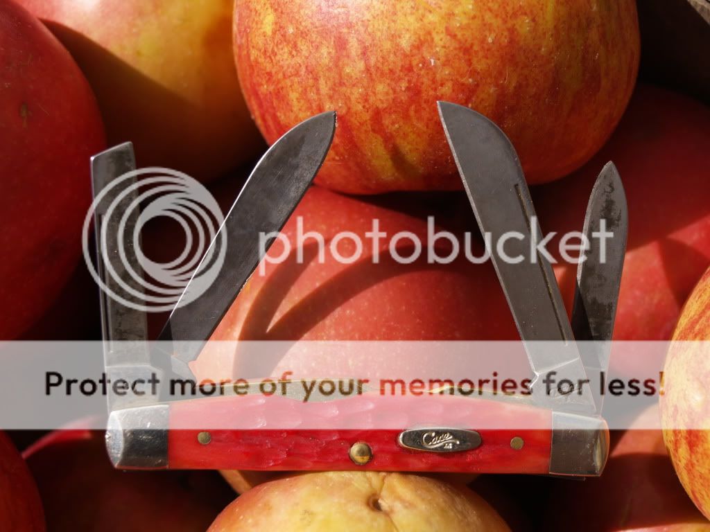

What I want to know is (and more information might come from the older guys here) what will give one of my knives a nice, dark-grey patina?
I am talking about while using the knife. I am not asking how I can force a patina. I want it to be a real-use patina.
I am trying to carry nothing but my Large Case CV Stockman, and I have a couple of stains on the blades from rubbing and cutting fruits. But I dont know if I am hindering the knife from getting a real patina by rubbing the blade down with oil frequently or what?
I dont want to mess the knife up, but rather I am wondering what will enable the knife to eventually acquire the kind of used look that I am describing?
How long do you guys think that this could take if I go ahead and use nothing but this knife on a daily basis for "normal" cutting chores?

Since you don't want to force it, you will get the best results from just using it. Will look a little uneven at first, but think about the old knives you see with a nice even patina...that just came from use. One of the nice things about natural patina is you can't control it too much. :)
From my own experience, the best thing is not to over oil the knife. I just give mine a little oil here and there but mainly just keep it dry after use. My main user is getting quite grey but it takes years to get that real aged look :)
Good luck
Developing a patina from real use will depend on what you will use it for and how often. If you cut food or other organic matter, it will develop a patina more rapidly, but any carbon steel will darken over time just due to your own handling of it. Routine oiling will not prevent a patina from forming over time, but may slow it down some. It will prevent the rust and pitting that some folks call patina (it's not it is just rust) and that will be a good thing.

Use it. Fruits, onions, potatoes, hot meats, and mayo will all contribute greatly. So pretty much kitchen type tasks will affect the patina the most. I don't know what tasks you consider to be EDC type tasks, but cutting things like string, cardboard, and plastic will do basically nothing for a patina (pocket carry can however influence patina).

For what it's worth, cutting Granny Smith's apples darkened my CV 6375 faster than anything else I've cut with it, including lemons, limes, oranges and other kinds of apples.
the granny smith apples really put a patina on my yella meduim stockman, i have one a couple of times a week at work as a snack in the afternoon. it's a very nice solid grey with a little blue in the edges, but it also gets used on everything else from cutting packages and mail, to bondo and plastic. i like that it's getting a used look, it'll remind me that it's been a good friend in my pocket for a long time someday.

Forced with alternating apple and orange for total 2 hours (an experiment).
Natural with 45+ years age and use (lots of experience!).
In my experience, the best things are apples and meat that has some kind of sauce on it (BBQ sauce is good).
The only patina that is on the blade is from after I cut an apple up while eating it.
I don't see cutting apples up as forcing a patina if its something that you generally use a knife for.
